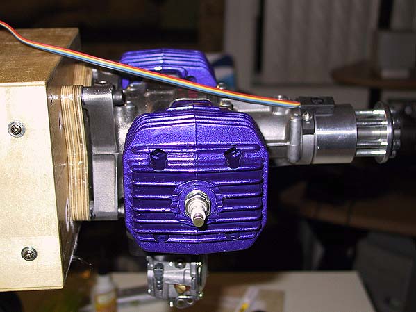

Here's my H9 Sukhoi with a 3W106.

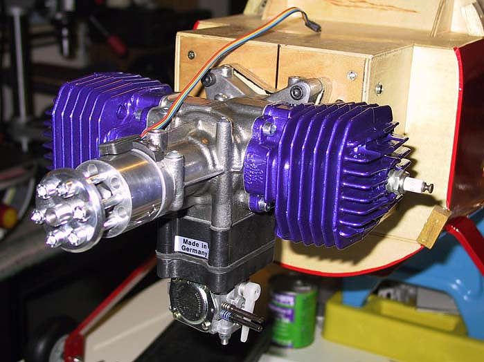

PIC 2

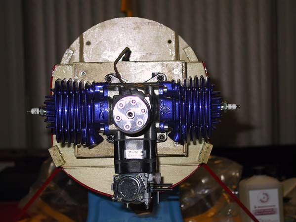

PIC 3

Wow - sounds like it is a little hoarse.

Nice thing about the BME100 in the sukhoi...no cowl cutting. I would hate to see spark plugs sticking out the side of that cowl!

I cut holes -even if they don't stick thru-
makes it easy to do a plug check
