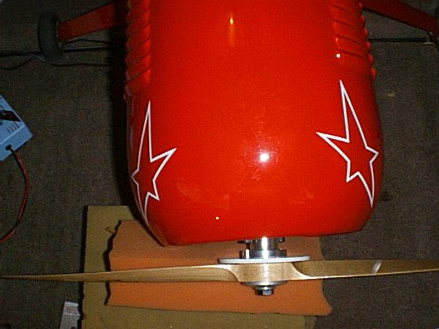

Dick. Nice pictures. Enclosed is pic of my H-9 SU31 equipped with Zen 80. I have the prop spinner out away from the cowl like you, but I'm not sure what the benefit is. I haven't noticed anything exceptional about the setup. I am having trouble getting the bird to set up a glide for landing because I think maybe the prop 24x10 is pulling a little too hard. I am reluctant to slow down the rpm because I don't want the engine to die, in fact, I have a high idle setting that I use during maneuvers and go to landing idle setting for landing on final approach. NSSHERLOCK
Posts: 71
From: Irving,
TX
Posts: 71
From: Irving,
TX
Dick:attached is pic of my nose of my h-9 su31. I have quite a bit if space between the cowl and the spinner back, but I have not noticed any benefit from this if any. What is this supposed to do. Cover up the fact that I screwed up when I measured and mounted the cowl, of is there supposed to be dome real value??

Dick,
Does the wooden dowels work good for an engine standoff? I was thinking about using a wooden box to stand it off, but the dowels would be easier. Did you use oak dowels? What diameter? I have a H9 1/3 Cap that I'll be putting my ZDZ 80 single on.
Wade
Wade
My Feedback: (18)
Wow, those standoffs are wood??? I coughed up $37 for aluminum ones... too bad you had to cut the holes in the side of the cowl! I have a BME100 in mine and it fits with room to spare. I mounted it 1.5" forward for cg reasons... Got six flights on it so far, lots of fun. Motor is brand new, but still have large surplus of power...

The wood setup is actually far more rigid than the metal standoffs - as each one has a triangle attached -which extends to each corner of the motor box- I prefer that setup -
