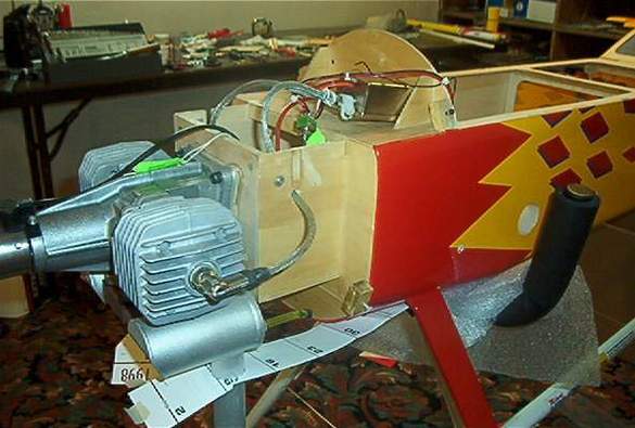

Can anyone post some pics of the ZDZ 80 single on this plane? In particular I would like to know if the motor box needed standoffs, or firewall cutback, or carb behind firewall ect. Wood/alum. standoffs? I have a Sukhoi on the way and have chosen the 80RV. A verbal description would be great too.

jelaird, I used 1.5" standoffs from RCshowcase to mount the ZDZ80. The capscrews are 10-32 x 2.5" with blindnuts behind the firewall. I had to cut the firewall for carb clearance. Also a picture on Chiefaircraft.com.....link below.

Thanks Ray!
Looks like you went for a firewall to spinner backplate dimension of 7.5". I might try 7.75" to save "some" nose lead so I would need 1.75" standoffs I think. Any problems getting your hatch open with the cowl overlap?

Jelaird, your right 7.5" which is the same distance if you use a Zenoah GT80 so everything should work fine. To get 7.75" all I have to do is get (4) 10-32 x 2.75" capscrews and add the 1/4" spacers that came with the standoffs. RCshowcase standoff link below. Hope this helps.
Ray
