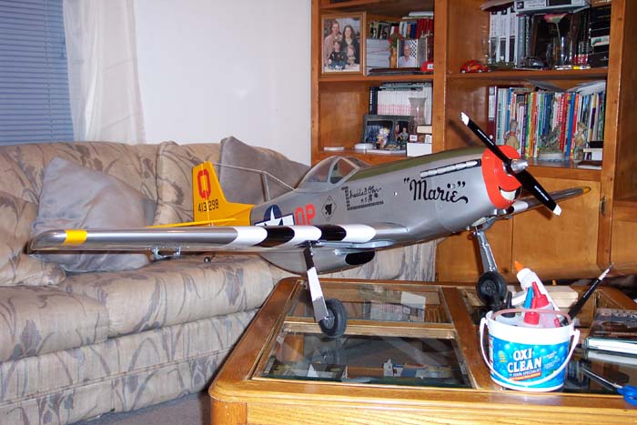

Anyone have any ideas on how to attach the supplied arieal to the fuselage on the h9 p-51? The top deck behind the canopy is foam(what was h9 thinking?) underneath the ultracote. I tried 5 minute epoxy but there's no strengh, and ca melts it. My big hands won't fit down inside to build a wood frame and attach it to the airframe. Would appericate any ideas.

Well, you are all correct as I see it, CA melts the foam, epoxy wont work, and I have also seen 5 of these Planes and None had the antenna mast installed. Well mine does.....or did. After the CA melted away the foam I made a receiver pocket from scrap balsa and installed by long tweezers, cut slit in top of fuse and there you go!!!. The only thing is, it is very hard to keep from hitting and breaking off while servicing the plane, installing wing/ removing wing, transporting, etc. Good Luck what ever you decide. it is a SUPER PLANE to fly, LOVE mine...

On my Hanger 9 P-51 we mounted the antenna mast using MEDIUM CA. We did this by removing the covering around the contact surface on the mast itself and applying ca on all the sides of the bare wood but the bottom which contacts the foam. With the hole properly cut out, just slide it in and set it straight. We also put a drop of ca on the top to secure the antenna to the mast. Works great and looks great! Might post a pic if you want to see it!
