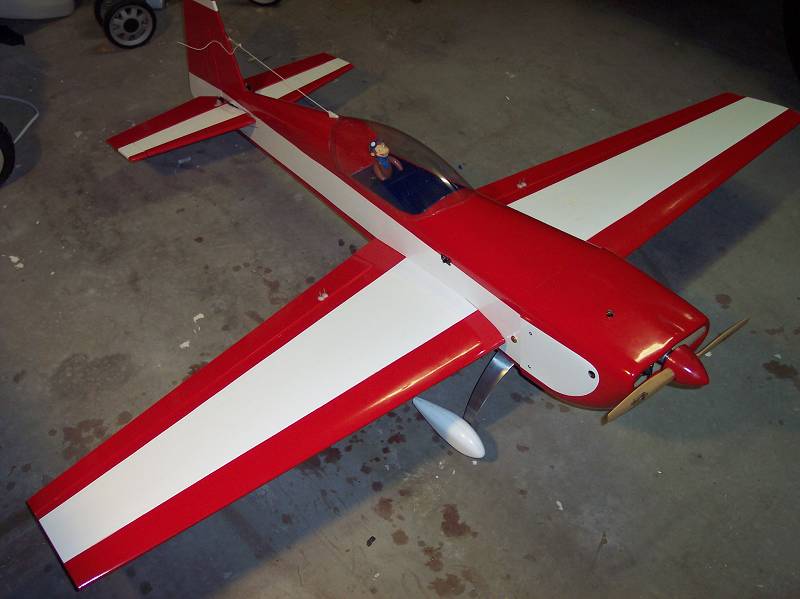

Well, I just finished the build on mine. I have a O.S. .60 two stroke in it that I still have to tune in, but it is otherwise complete. I built up a cockpit and put in a pilot, but neither is very detailed I added some fiberglass to the inside of the fuselage where the landing gear are mounted and to the wing joint. I also installed a Great Planes Easy Fueler mounted on an L-bracket to the firewall and a fuel dot t'd into the vent line that is mounted on the side of the fuse so I don't have to disconnect the fuel lines if I need to remove the cowl. I hope to have one of the better pilots at my flying field maiden it this coming weekend.

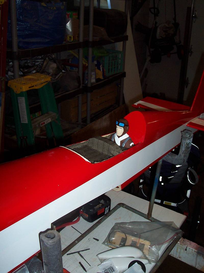

Looking good. I have made a little progress on mine today. Here are some pictures of my cockpit. I added a pilot and dashboard that I have as a jpeg that I printed to size. I also cut up an old skirt that my wife had and used as fabric in my cockpit.

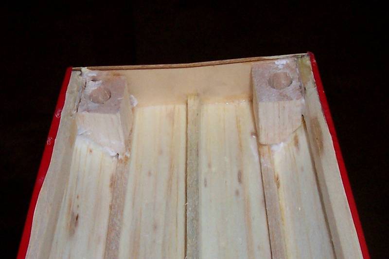

I also made some blocks on the bottom of the wing to hold the wing hold down bolts in place.

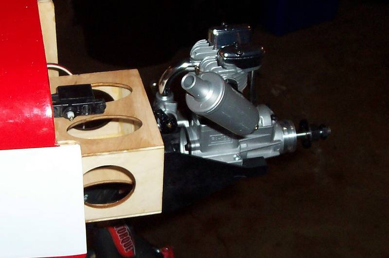

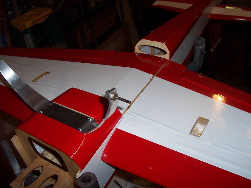

For my motor, I am going with a new Saito 1.00. I had a Magnum 1.20 Four Stroke on my previous extra and want to try the lighter Saito on this one. The mount is a Sig. Its the biggest one they make and allowed me to set my engine back almost all of the way to the firewall so my cowl would fit on. The plane has right thrust built in, so I offset my motor to keep my spinner centered on the cowl. I am going with a micro servo on the bottom of the motor box.

Here are some motor pics

Looking good! I've had a heck of a time getting this plane to balance right. Even with the fuel tank, receiver, and battery moved as far forward as I can get, I still had to add three sticks of lead weight (9 oz. total, I think) and I might need to add some more....any suggestions?

Well, it flew beautifully! The only problem I had was the stupid Great Planes Fueler Valve caused the engine to die at idle on occassion, so i routed my fuel lines around it. I guess I'll go to a three line system after all. The plane was balanced well at 3 3/4" behind the leading edge. I have to say that the wings are damned strong on these things, too. The guy who was maidening it for me had to do a deadstick at a fairly low altitude and managed to bring it in safely, but he hit a rubber traffic cone with the left wing. The plane spun around and had a little crinkle in the leading edge covering, but the wood underneath still felt sturdy and there was no other damage to the plane. Once I get the three line system set up, I think she'll be good to go and should be a great plane to fly. Even with a OS .60 FP and a 12x6 prop it seemed to have good power, but not unlimited vertical.

I did some more work on my plane today. I now have all of the servos in. I upgraded the pull pull cables. I used the dubro system in my previous plane and this one.
I also sheeted the top of the landing gear formers. I also laid some 6 oz cloth over them with epoxy and then filled this area with expanding foam. That should add some strength to the landing gear. I am also going to use some bolts that will break away on a rough landing.
