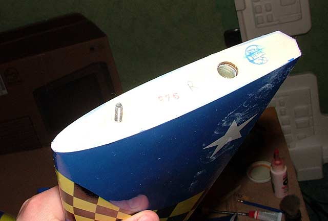

What I don't like:
point hinges (changed for Robart one)
stab installation method (manual say's to glue stab to fuse using epoxy. there's no mention about additional "pegs" so I used a 4mm threaded rod)

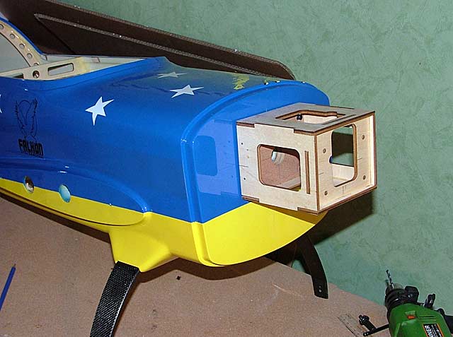

It's designed for ZDZ-40, so I don't have to modify an engine box (I've a ZDZ-40 motor).

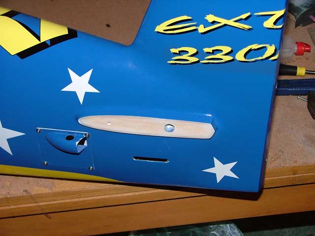

Its seems like u are using the stock elevator horn..are they pre installed or not? would you think its suffice enuff to have that horn...

Yes, I'm using a stock horns. They're a part of hinges, so I decided to use them. The rest of hinges I changed for Robart ones.
