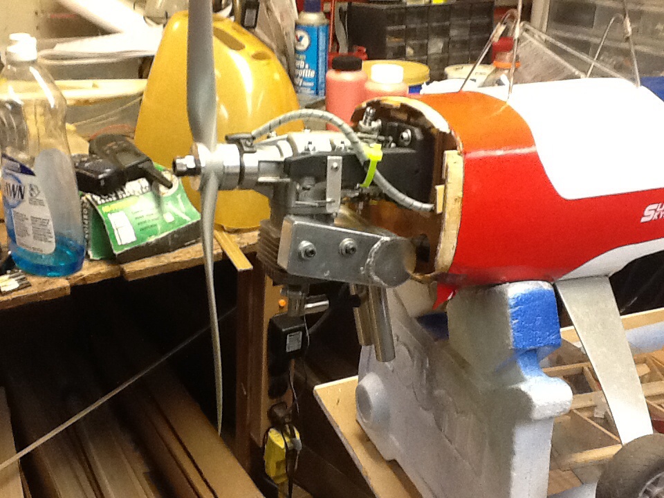

Has anyone tried stuffing a DLE 20 RA in the bolt yet I'm thinking about it just not sure if it will work any thoughts
Old 10-11-2015 | 03:59 PM
  #866
stevegauth30's Avatar
Joined: Jun 2012
Posts: 4,002
From: Bristol, CT
been there, done that. All i can say is you wont be dissapointed. You will, however, have to cut your cowl to pieces.

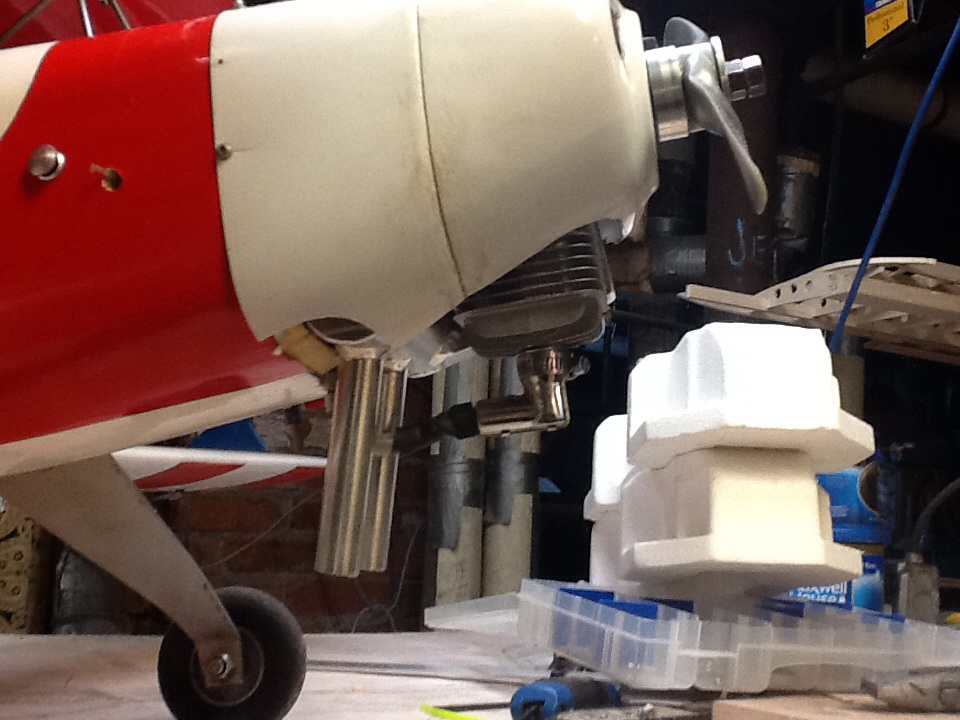

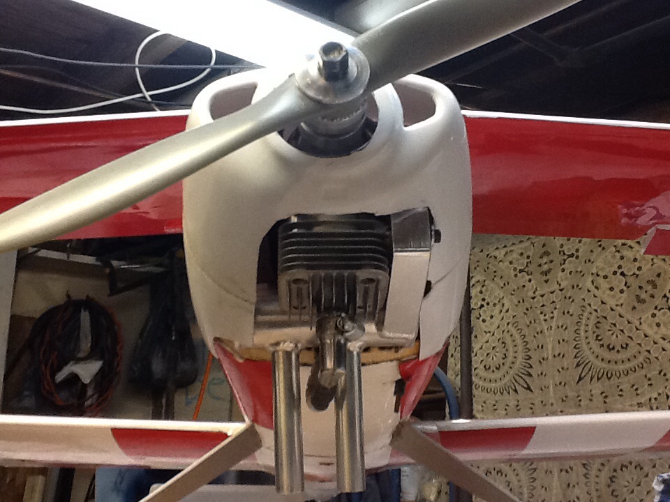

have you any photos of the one you did
Old 10-12-2015 | 01:06 AM
  #868
Joined: Jun 2012
Posts: 4,002
From: Bristol, CT
Here you go. Man, that was a fun little bipe.

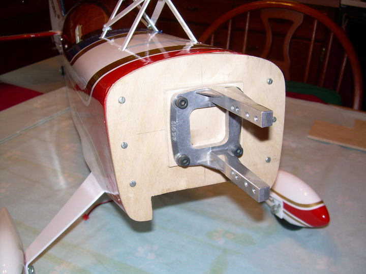

Originally Posted by wannabapilot
Thanks for your photos stevegauth30 it looks like yours was a kit build I'm looking to put a DLE 20 RA in the ARF and was wondering if anyone has done it or if it will even work
I installed a side exhaust DLE 20 in mine and it was no problem. I have not finished it yet, but will this winter.
Gordon

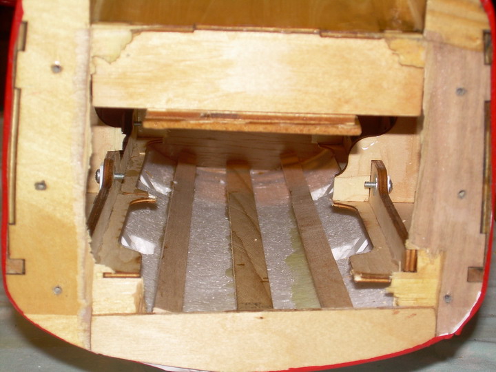

... it seems that the early ARF may have had a weak firewall and I'm not sure if they addressed that issue in the later runs
They didn't. I just opened my recently-purchased kit and had a look; two 3mm pieces of light ply laminated together. It "interlocks" into the fuselage sides, and has a couple of small pieces of tri-stock, but you can pretty much forget about beefing it up further from the back side; too much of a stretch and too much structure in the way.
The box says a .70 four stroke is acceptable. I find that a bit… optimistic, at the very least. No joy on the 1.20 Surpass I was promised, so I'm back to deciding what engine to get. I want plenty of power, but I don't want to bust that flimsy firewall loose with too much power.
This is annoying...

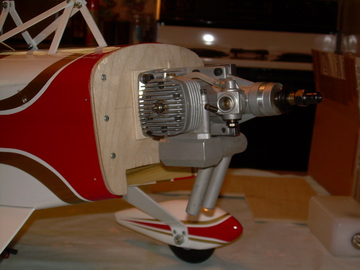

LSP 972- The most recent GP Skybolt ARF is pretty much the same as the earlier ones, with their selection of wood that thay use. I bought mine used/ wrecked at a swap meet, and only the firewall, and front formers were damaged. The previous owner that I bought it from has an OS 91 4 Stroke in it, and on his 2nd flight, he ground looped it, and the OS 91 went straight back and took out the firewall and F1-F4.
I did a refurbish of it, and have an article in the "Crash/Rebuild" forums here on RCU. If u go to that forum- go to page 4, and look at my article "GP Skybolt crash find" near the bottom of P4, and u will see how I rebuilt the front end, and added a lot more structural integrity to the front airframe. When u go to fly urs, make sure u let ur groundspeed get hi enough, and it will lift off effortlessly. You also may want to cut, and add an additional 1/8" ply firewall to the existing one for added support. I'm flying mine with an OS 61SF long stroke, and it will do anything I want it to. Here are a couple pics, but u can check out my article if u like. Let us know how u will progress with ur assembly, and maiden flight- Best of Luck-- Dean

Many thanks for that, Dean. It looks to be the simplest solution to the problem.
I let a 1.08 FSR get away from me a few years back… sure wish I still had it for this airplane.
It will be a while before I get around to starting this one, so I've got time to select an engine. I'm just real hesitant to buy used these days...
