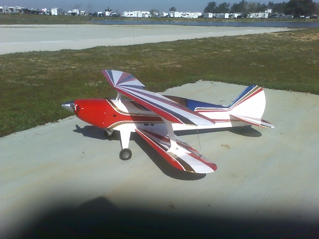

#618
To celebrate the Maiden Flight of my Skybolt ARF I'm posting a picture just after the first full stop landing. The engine is an OS91FS 4 Stroke, Wildcat fuel, MA classic 14X6, JR 7202 gear, using all low rates, and all trims were centered. very light breeze down the runway. It landed very nicely and as you can see, all in one piece. The wheel pants were left off on purpose. I'm looking forward to trying the Graupner 14X6 like MinnFlyer uses. I didn't weigh my Skybolt, but the OS91 was enough power, but certainly not OVER powered. I'm excited because this is my first bipe, first 60 size plane, first tail dragger, first 4 stroke, first coweled engine.
Thanks for all the input from all of you guys.
MK
MK
