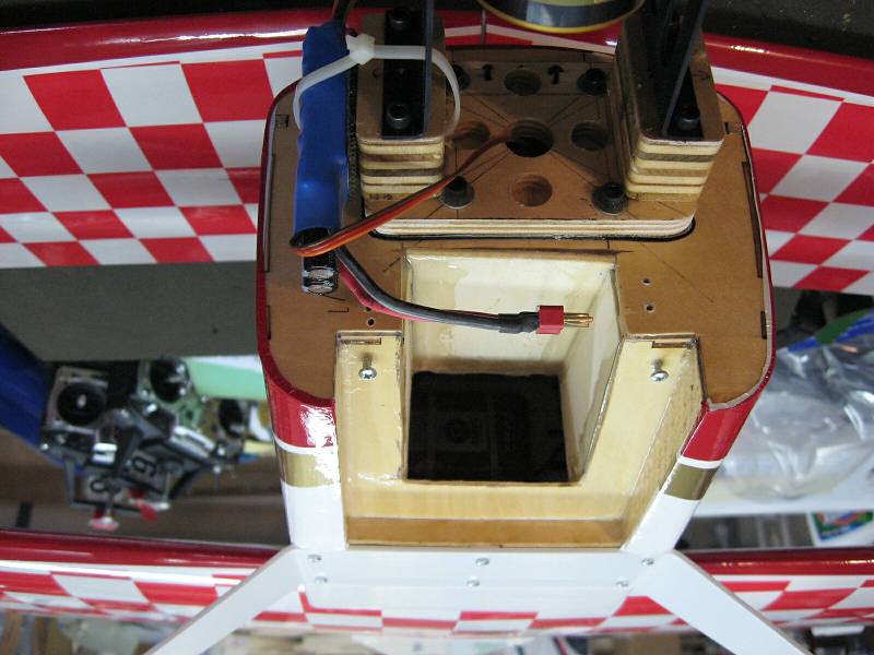

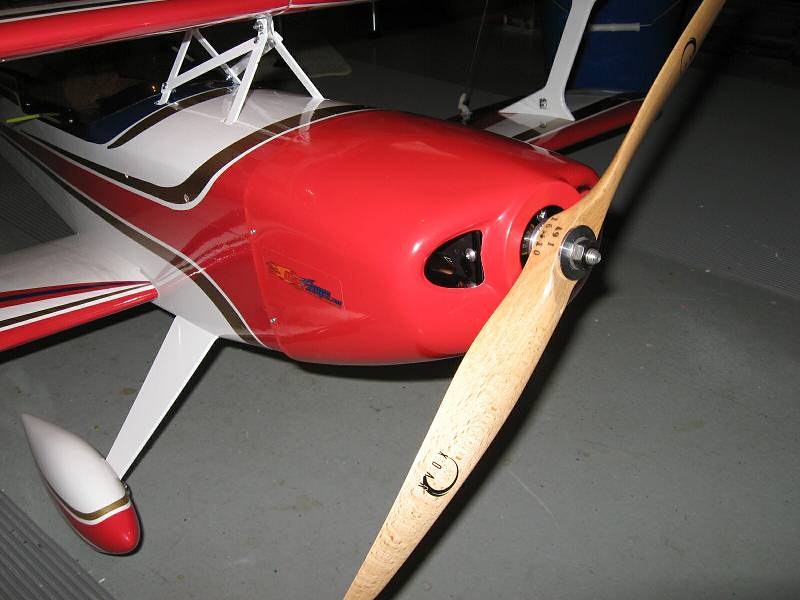

I just finished mine and decided to go the electric route! Used an AXI 4130/16+JETI 77amp controller + 7c 4200 Maxamp LIPOS... 16X10 prop ...haven't flown it yet but on the ground I can barely hold it at full throttle, it should perform very well AND no GOOP on the plane after flying and there are no cutouts required on the cowl! see pics

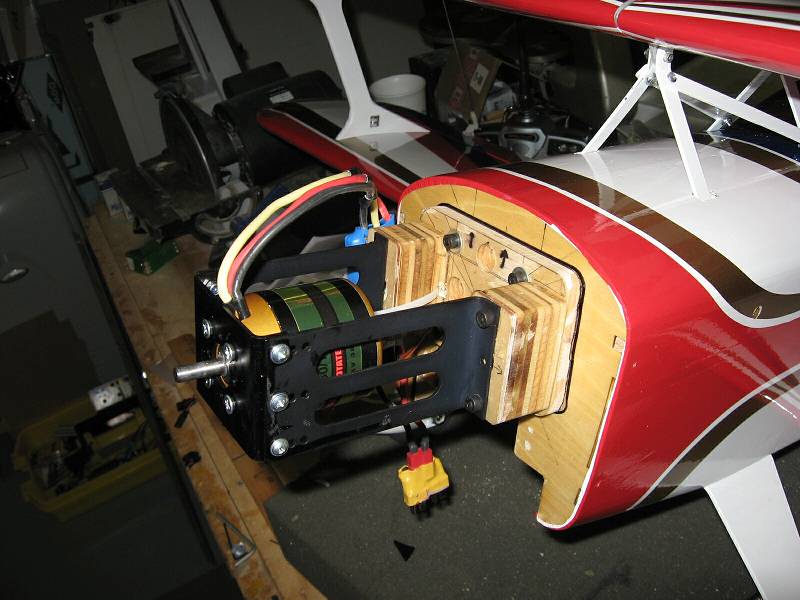

Here are some more pics of the ELECTRIC version! The spinner is on it's way from TRU-TURN!

Pretty slick!
Great idea to invert the ramp behind the firewall into the battery holder.
How about a pic with the battery in place so we can see the fit?
Thanks!
