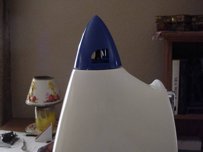

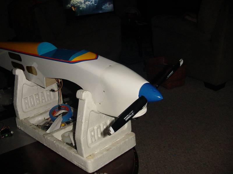

I mounted the engine on the mount; kinda screwed that up. I tried to leave room for the carb in back, but forgot to leave room for the mount bolt heads. [:@]
I then sat the engine and mount on the firewall, holding the plane vertical of course. I put the cowl on the fuse and just move it around until the shaft sat in the center of the hole. I did have to cut some area away for the head before I could get it work. I also put a spinner on the shaft to see how it would look.
Here is a pic with the spinner sitting on the shaft and then the final mount of the engine and cowl.

Got the entire nose section complete and the tail feathers are on. I just need to install the elevator setup to complete the tail.
I decided to go with a 13X8 for starters. Went to the LHS to get one and all they had was MAS. No worries, I'll use it until the APCs come in.

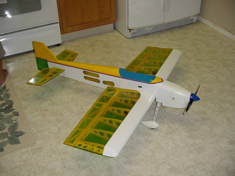

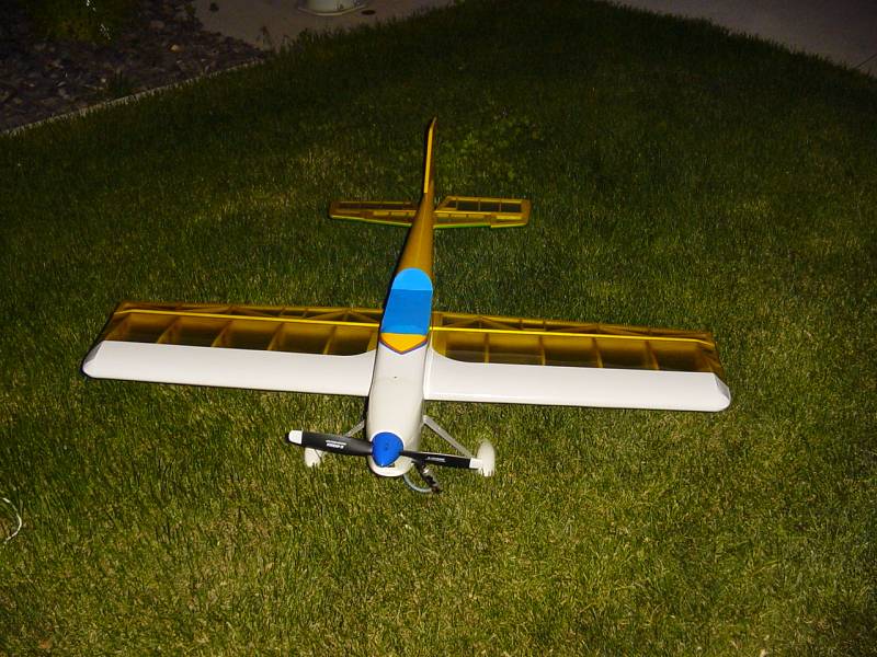

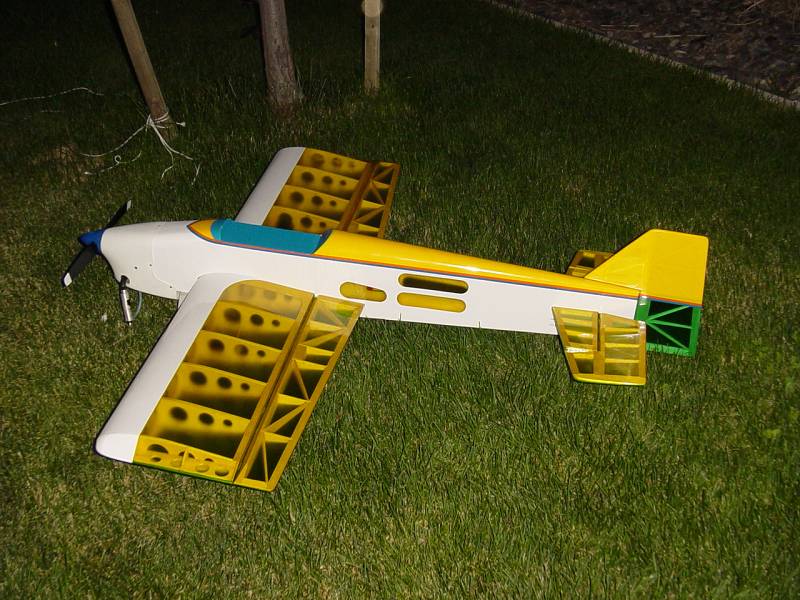

It's been a few days, ok a couple of weeks, but I finally got it done.
I had to do some mods on it to help reduce the weight but I think they will all help out in the end. I moved the throttle servo forward, just behind the fuel tank. That allowed me to move the rudder servo forward in the servo tray. I had to cut some of the wood from one side to allow the servo to sit more toward the center of the plane. This allowed me to put in a longer arm for more throw. I had to redo the pull-pull wire but that wasn't a big deal.
All of this with the heavy hub and lock nut inside the spinner I got it to balance, juuuust forward of 3". I did have to get a wire cable for the throttle, that wire didn't like the bend needed for the servo to sit so close.
Here are a couple of pics of it all done. Using the old Mk1 Mod3 bathroom scale it comes in right around 6lbs. I start my shift tomorrow so I'll have to try and get it into the air on Sat.

I don't remember what prop I put on, but I got the blue spinner as you can see in my pics.
I put on a Saito 72 and it came out tail heavy as well.
