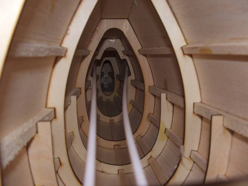

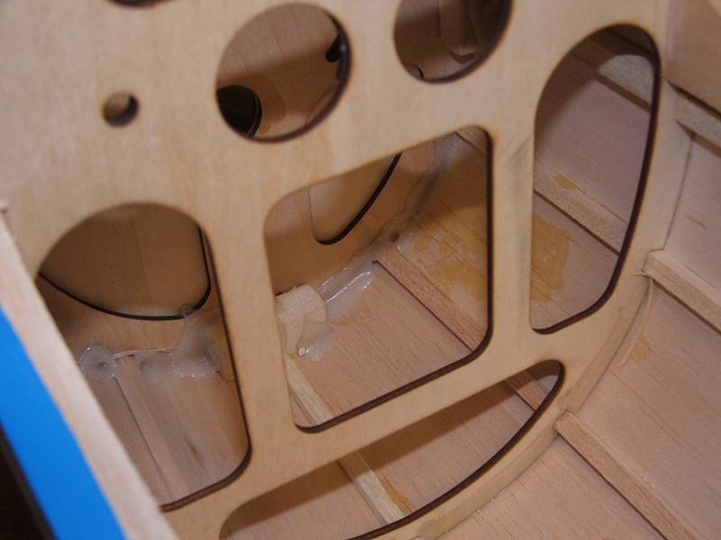

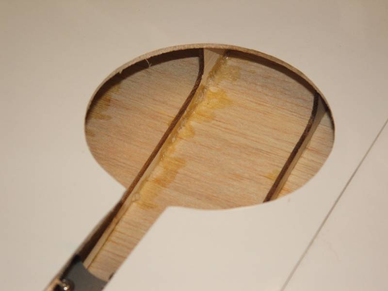

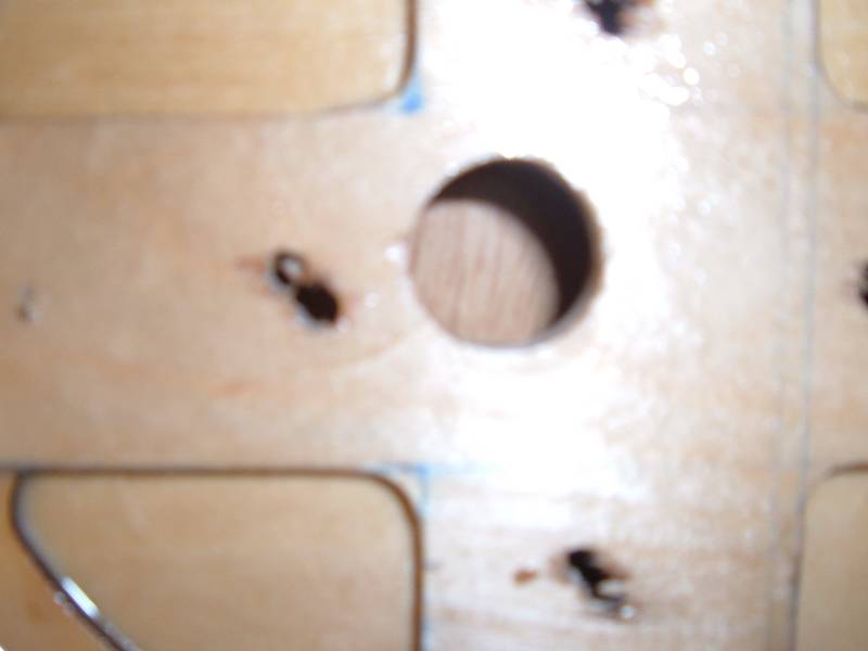

THESE ARE JUST A FEW OF THE PROBLEMS I HAVE FOUNF IN THIS ARF
1 THE FIREWALL IS GLUED IN VERY SLOOPY AND I DONT TRUST IT WITH AN .049
2 THE FIREWALL IS TOO THIN I WILL BE CUTING IT OUT AND REPLACEING IT WITH FULL 1/4 INCH PLYWOOD
3 THERE IS NO SUPORT FOR THE PUSH RODS IN THE AFT OF THE FUSE
4 THERE IS UNNEEDED GLUE EVERYWHERE ON THIS THING
ID:	483494   Click image for larger version
ID:	483495   Click image for larger version
There were numerous complaints about the weak firewall in H9 ARF's in the past three or four years, but H9 didn't seem to listen or care.

AS FOR THE FIREWALL, I WILL LAMINATE MINE WITH 1/8" AIRCRAFT PLYWOOD AND REPLACE ALL HOT GLUE WITH 30 MINUTE EPOXY AND TRIANGLE STOCK. THAT SHOULD DO IT.

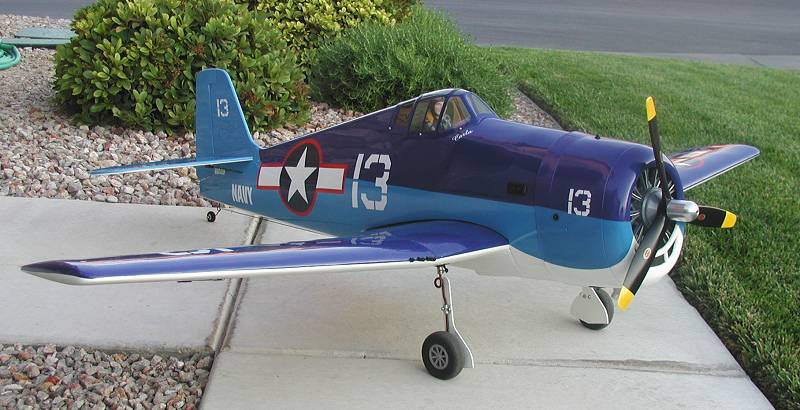

Skrshark RC has the Hellcat ready to build. Let me know when you get yous done. Here is mine. The Hangar 9 in my opinion is eaiser to fly and by far much cheaper to build.

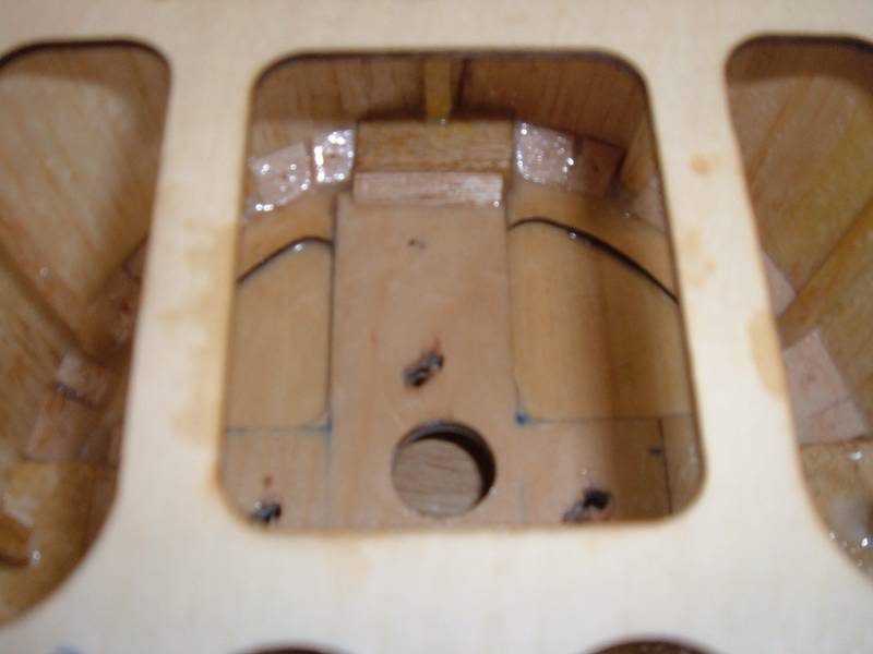

Bgulino,
I too redid the firewall. If I don't like my Saito 1.00, I will put my YS 1.10 in it. I pulled out all the hot glue, and put in 1/2 triangle stock w/ 30 min epoxy. I also put in a reinforcement made of 3/32 aircraft ply the same shape as there doubler (you could flex the firewall with one finger in the hole originaly. I added 3 oz's to the fuse weight. My fire wall will not loosen or depart the fuse.]
I still have to finish the mounting slots. Here is a couple pic's.

Thank you for operating the shop in that manner. I wish that everyone did. When they (H-9) announced the Hellcat, I questioned the marginal firewall, and was immediately jumped on by the loyal Hangar 9 group. I suspected that the model would have the same issues as did the Corsair, and the 60 size P-47. It would appear that it does.
I have only owned one ARF airplane, and that was the 60 size P-47. I completed it (it took far too long to correct the inadequacies) and flew it to trim it out. It was a well flying airplane, and I immediately sold it as a complete ready-to-fly model with radio and engine. I will not buy another ARF. I enjoy building from kits, and from plans as well as from scratch (draw my own plans). I do frequent the ARF forum in order to see what is coming down the pike, and to lend assistance and offer help to those who do not have enough experience to know what to do to correct a problem. I am not anti ARF, I just don't enjoy owning something that someone else built.
As a side note, the H-9 ARF's are not the only models to have firewalls that are too thin. Several well-known kits also reccomend and include firewalls that are marginal. In that case, it is very easy to manafacture a firewall that is thicker while building the model. It is always easier to do something right the first time , rather than having to go back and rebuild someone elses screw-ups.
The argument that you should expect to have to do some work to fix the problems with an ARF does not wash. We (the people who build and fly them) should demand better treatment. These business' listen with the bottom line. While I am not advocating going to war with any ARF distributor, I think that the problems with these models are widely known, and just ignored. What to do? Obviously, griping in this forum is not doing any good. Short of a general Boycott of the products involved, I don't have any idea what would work. You guys need to demand something better than what you are getting. Just my thoughts on this.
