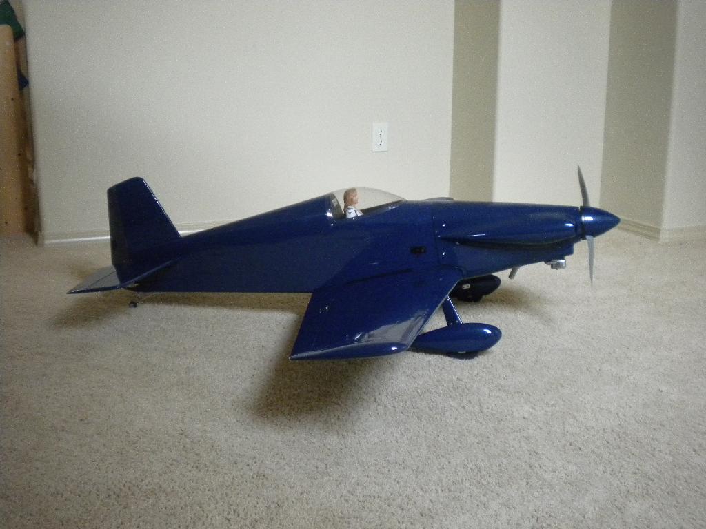

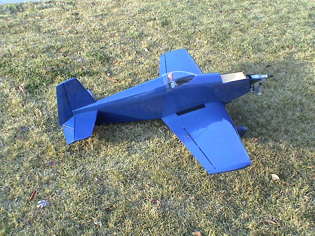

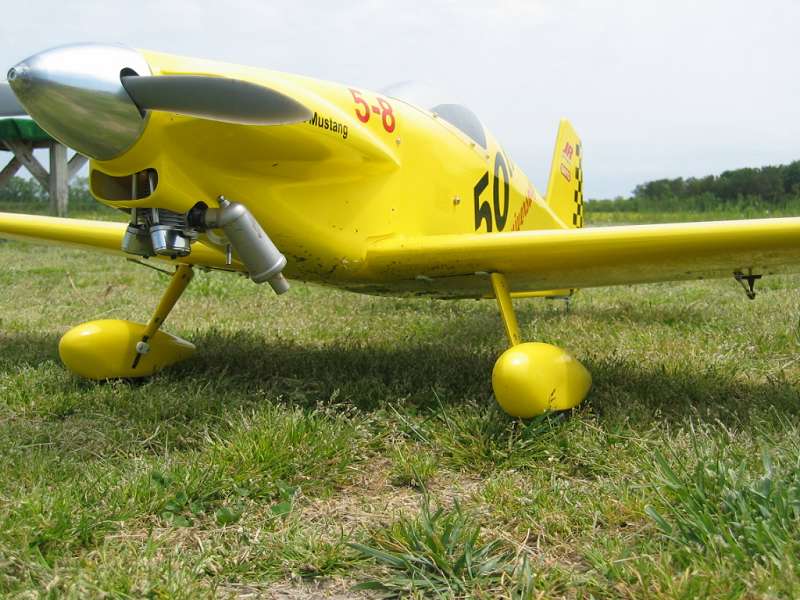

I have the cub yellow one nib.
also have a saito 120 with hatori cooling header for it.
Here are some pics I have collected.</p>

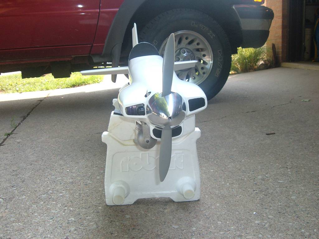

Some more...

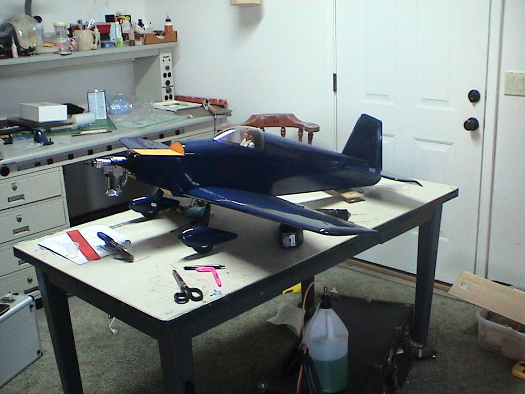

Thanks plopes for the pictures, cant wait to start mine. Gotta finish my GP ultimate bipe 1st, in the process of coveringit now.
I also have the navy blue one and i'm going to put a 91fx in it. It should be pretty fast. I'm also going to do a white checkerboard on the bottom of the wing.

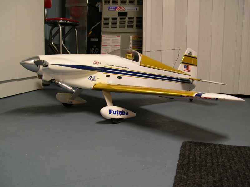

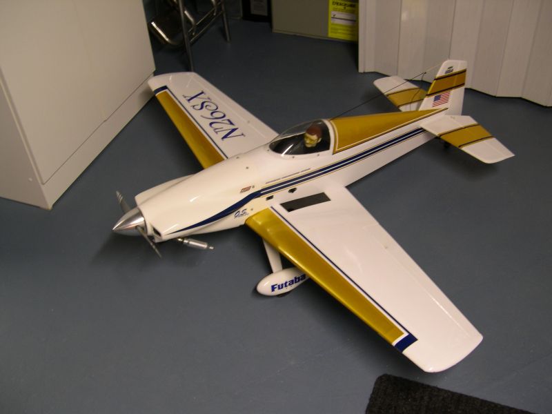

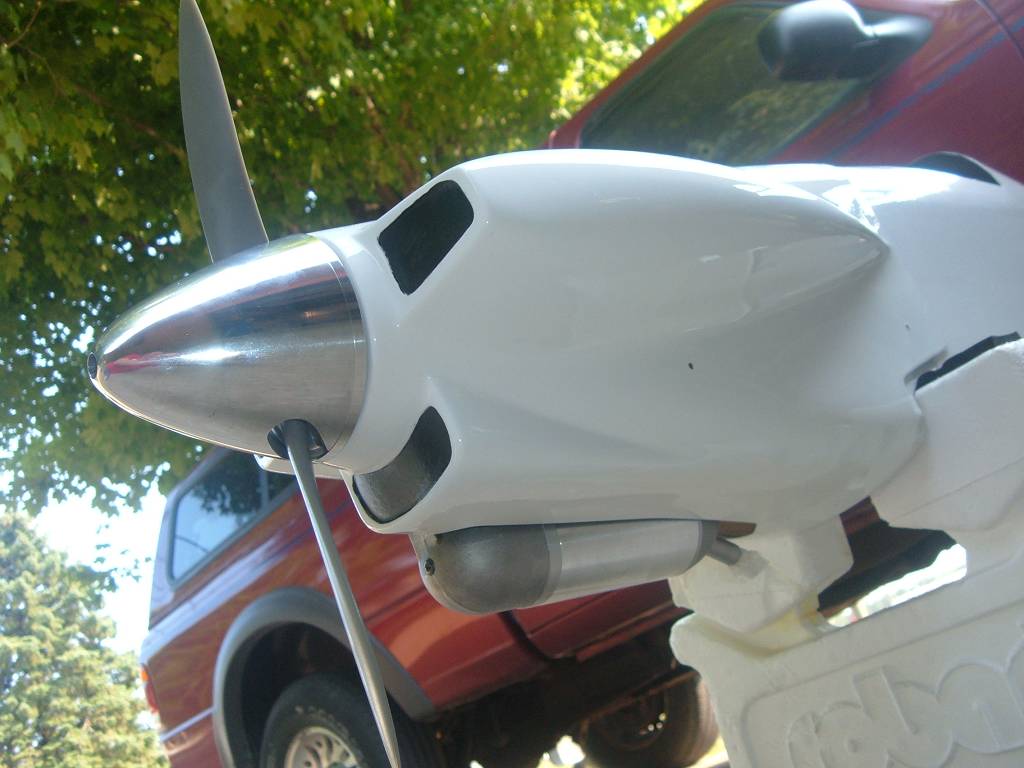

I am working on one at the moment. Side mounted Tower .75 with stock exhaust. I think it should go quite good. It took a little work to get the muffler to fit.</p>

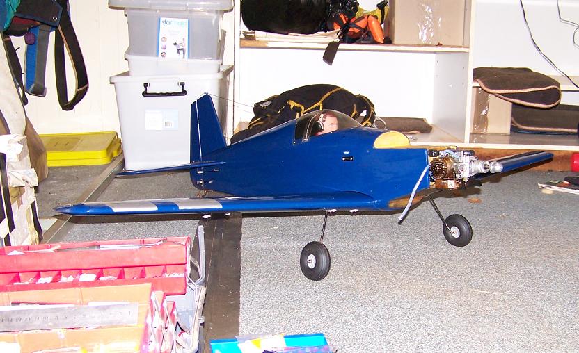

Hi guys interesting pix,beautifull looking aeroplane.A pix of my cm pro midget with saito 115.How do your's fly?

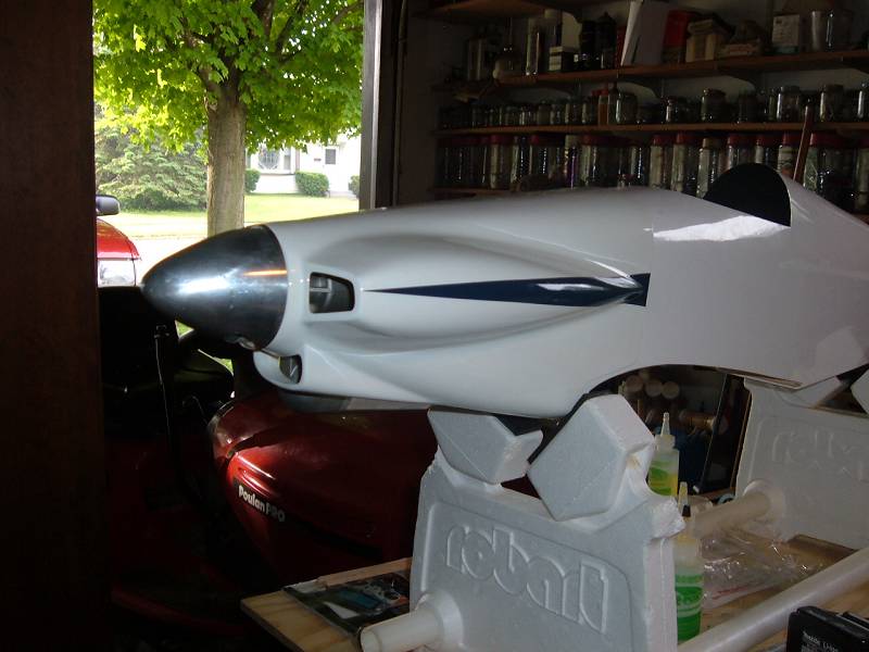

Well, I have the engine installation completed, but am concerned about engine cooling. I blocked off the rightside inlet and the bottom scoop to try to direct air over the cylinder. I have a total of 3 times the inlet area for cooling exits from the slits in the side of the cowling. The firewall is fiberglassed on the outside, and triangle stocked on the inside. I also had to build the fuse up on the inside to enable the notching on the bottom for the stock muffler to be used. I did not want to run a pitts muffler again. The wing center section is glassed, and 5/32 music wire will be bent to replace the stock WM wire gear.
I also installed servo mounts in the fuse for dual elevator servo's. I hope to have it flying in a week or two. This has been a long ongoing project for me, since I put it aside all the time for my other planes.
What do you guys think of the factory recommended elevator and rudder linkages (pushrods)? Has anyone installed pull pull for the rudder? Any other tips would be appreciated.

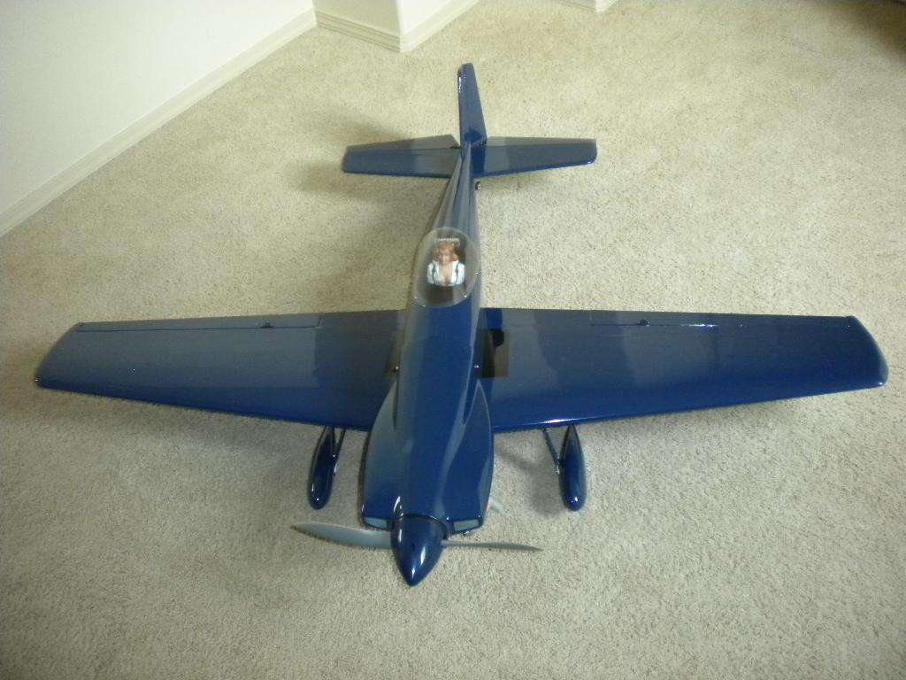

Here is mine guys. It is the older version, got it for $300AU NIB a couple of years back and have flown it hard ever since. I run an OS61 with 11X9 and Pitts muffler and JR gear with 539's all round. It does it all, even knife edge. I have the ailerons set to 10 deg or so up to wash away lift while landing and nail it almost every time. Did three eight minute flights today at full niose and had a ball.
It is pretty quick at ten feet banking hard[>:]
