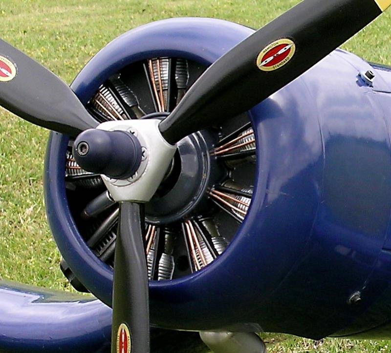

I've started on my H9 corsair and decided to use the Top Flite dummy radial engine. It looks much more scale than the Hangar 9 radial. I used acrylic hobby paints and finished it with several coats of Lustrecote clear for fuel-proofing. Check it out:

I used two different shades of gray on the cylinders, and the crankcase is a third shade. All of the gray paint was brushed on using Testors Acryl for plastic models. The silver on the valve covers is Testors enamel. The black background and the clear are Lustrekote spray paint by Top Flite. The pushrod tubes that came with the dummy engine were too big, so I used 3/32" wooden dowels blacked out with a magic marker and heat shrink tubing on the ends. I gave everything several coats of the clear to fuel-proof it, but only time will tell if it will hold up. I don't see a problem, since there shouldn't be any reason for fuel to get on the front painted part of the engine.

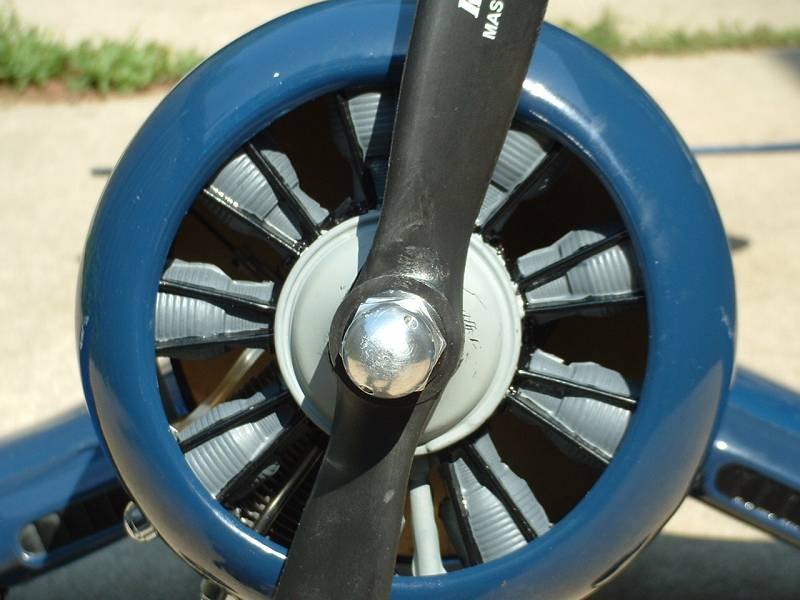

Sorry I did not post earlier, my computer would not upload files tonight I just uploaded some pics so let me try again. I used testors acrylic paints three shades of grey and silver on the heads.
Tom

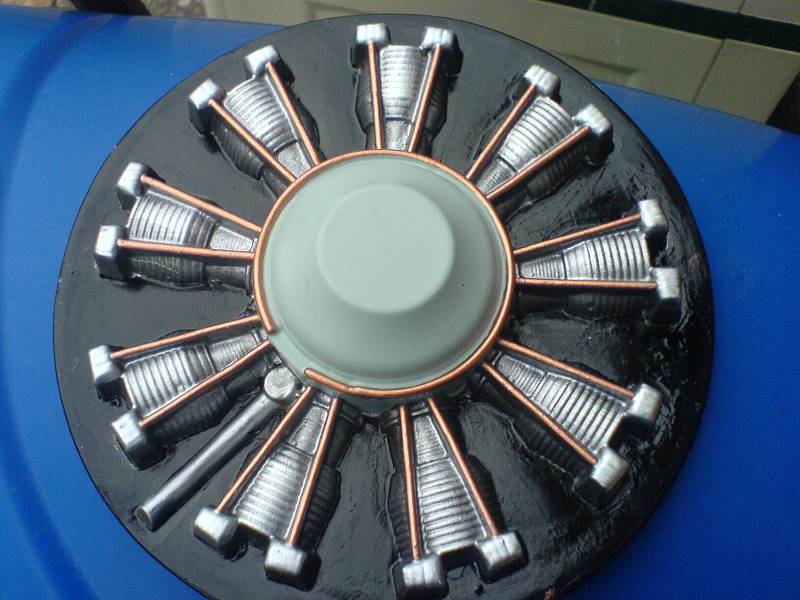

hi i opted out of useing acrylic and whent with enamel in the hope it will be more fule proof i used in the end (tamiya black)(tamiya light blue luftwaffe) and revell cooper,steel and silver numbers 93,91,90 i still have the urge to do more to it but i noticed when it is in the cowl you lose a lot of the detail so i ask myself is it worth it but still it will look good behind a nice 3 bladed prop here is some pics

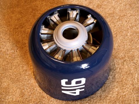

Here is my stock H9 dummy radial painted with Model Master Acryl, followed by two coats of LustreKote flat clear. Note that LustreKote cannot withstand 20% or more nitro.

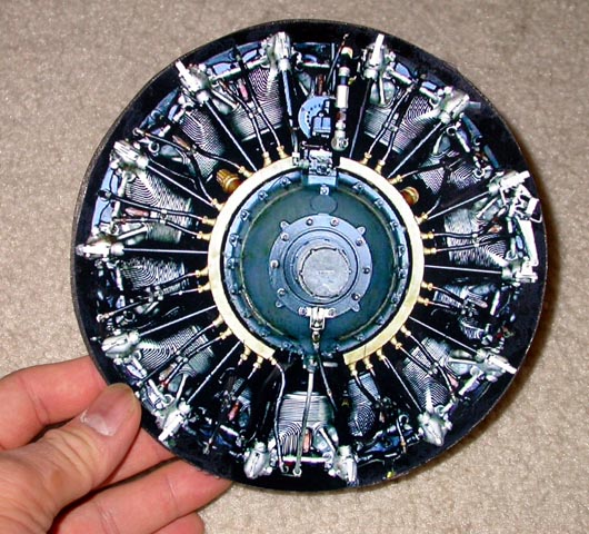

On my H9 F2G-2, I decided to go with a printed photo of the actual radial since the F2G-2 is powered by a P&W R-4360 Wasp Major 28-cylinder 4-row radial, with 7 cylinders showing at the front instead of the usual 9.

I made it to size and glued it onto a piece of plywood cut to fit the front cowl opening.

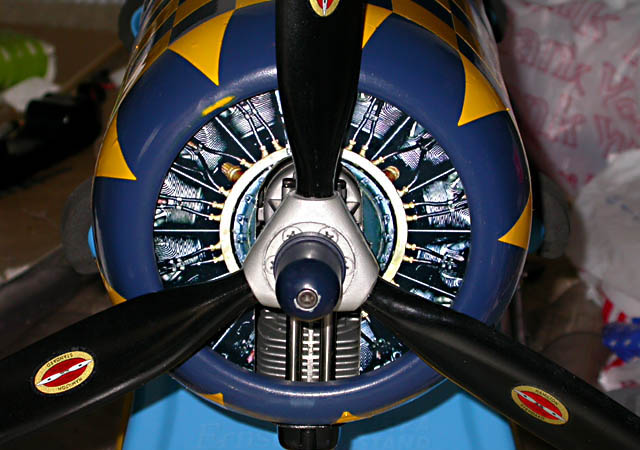

'Fred, I am not using any dummy radial engine. I also have a Top Flite 1/8 scale dummy, but it's too big in diameter and won't fit without trimming away the valve covers. The dummy radial engine for the Kyosho Corsair is slightly smaller and will fit better, but it still requires some cutting. The dummy engine you see above is just a picture of the real Pratt & Whitney R2800 printed out on decal paper and pasted on 3/32" ply. That's why I said it's "cheap and cheesy". Spinner is Tru-Turn 1-1/4" prop hub. '
