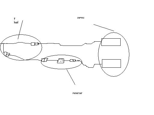

i have a great planes christen eagle II 29% and also a seagl models harrier 40 and these run dual elevator servos in tail, all i do is hook up a in-line servo reverser to ones servo, then attach a second extension up the fuselage into a y peice.
i shall try and post a rough pic ive drawn up as an example.

Thanks for the drawing! I think, with what little research I have done, the reverser is right in the Y harness, and on one line of the "Y", unless there is just an inline reverser that hooks into your servo exension line. I will do some research this week with our hobby store and see what he can order for me. Thanks for the great drawing!

the only way to run dual servos is with seperate channels with a good radio set, or the servo reverser, because no matter which direction you mount the servo the throws are always going to be different, such as this once again "rough" drawing. or even fourstrokes idea seems to be good
