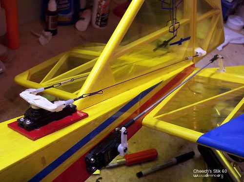

I read everything here about the STIK. Even though I really think this ARF is ugly, it does have charm. And it's supposed to fly super. I got talked into buying the ARF last Saturday.
I started gluing and joining stuff together on it after we got back on Saturday. I now have completed that Ultra Stik .60 . It's balanced, programmed and ready to fly. The engine is a Saito 100 and the seven servos are Hitec 605's on the ele & rudder and 425BB's everywhere else. The plane weighs 6 lb 9 oz completely ready to fly minus fuel . On the Chipmunk that Saito was turning a 15x6 prop on heli fuel, putting out about 12 lbs of thrust at 9000 RPM. I am hoping that this thing flies as good as the numbers look. A plane this hideous better fly GREAT.
I put the elevator servo and the rudder servo waaay back on the fuselage. I'm glad I did. I still had to shove the battery back to get this thing to balance.

And yes, rcpilot44, my elevator linkage is ball linkes at both ends . It is a very slop free, easy moving setup. I hardened the servo mount areas on the back with lite ply. Under the rudder servo I did a full little servo tray, covered then epoxied externally to the fuselage. On the elevator I put some lite ply on the INSIDE, behind the servo screws. It's a solid setup.
Again, I am REALLY REALLY glad I mounted the servos in the back. Even with those two servo's and all the hardware I STILL had to shove my battery way back in the radio compartment just to get close to balancing. It's a nose heavy plane. With the 100 this plane would need lotsa tail weight to come out close. I may still add an ounce to the back. To those that are actually FLYING your STIKs, where are you CG'd? I'm at about 4" now.

Cheech's Avatar
My Feedback: (19)
Posts: 842
From: Suburban Chicago, IL
Default Ultra Stik 60 Question
My tail feathers. I replaced that adjustable arm on the elevator. It was used during setup but I now have a a composite Hitec arm.
