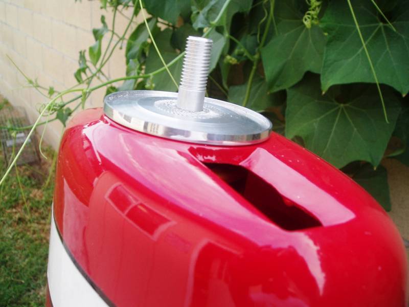

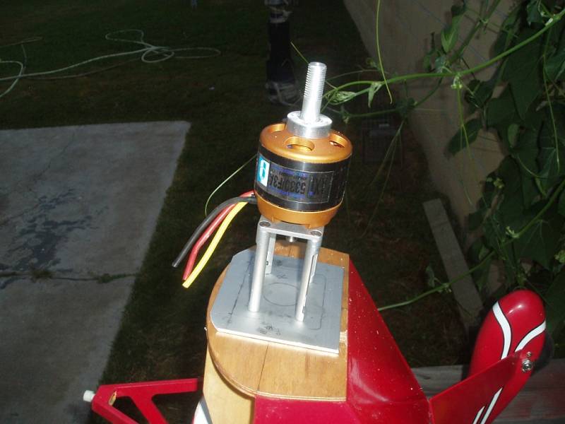

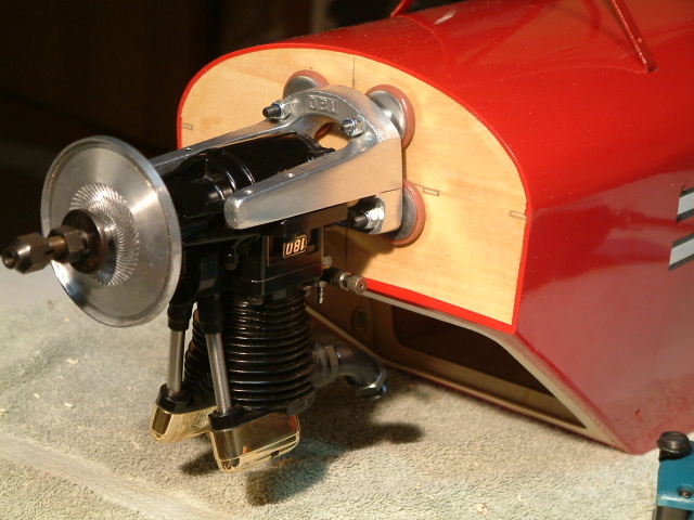

This plane look great and so do the reports. Mine is being delivered Monday. I have the O.S 120 AX on the stand ready for break in for the Pitts. I am going to clip the wings and remove all of the white from the red if it will come off. If not I'll recover. I am going to scheme it to match Sean Tucker's Oracle. I'll post pictures when I have something to show. I will also attempt to put smoke on it. I was fortunate enough to see Sean perform in Fort Woth last month thus the inspiration.
#48
Joined: May 2006
Posts: 496
From: CAMDEN,
TN
Does anyone have a picture of this plane with a 120 ax in it? How are you mounting the ax, inverted or side. Also which muffler fits the cowl best?
#49

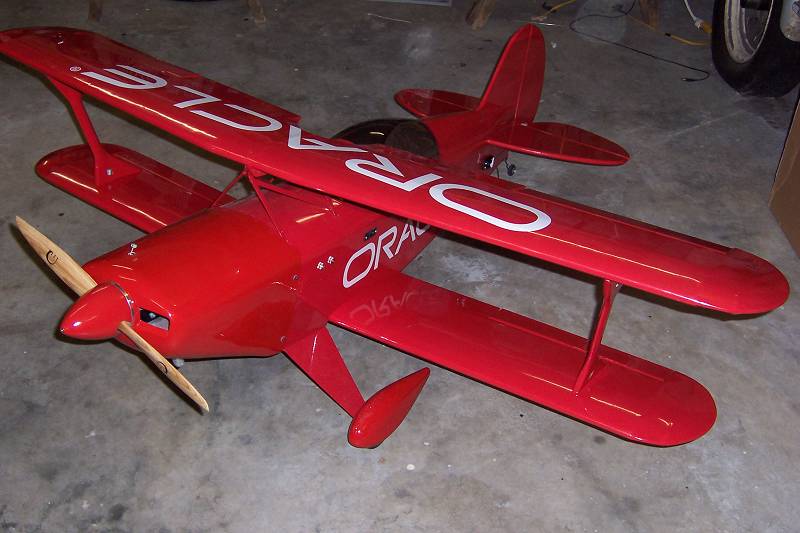

Joined: May 2006
Posts: 496
From: CAMDEN,
TN
Here is the progress on the Pitts. I still have the ailerons to connect. I also need to clip the wings and have a few more decals made. The smoke works great and should be a real crowd pleaser.
