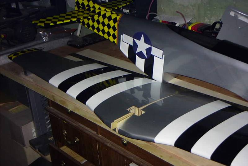

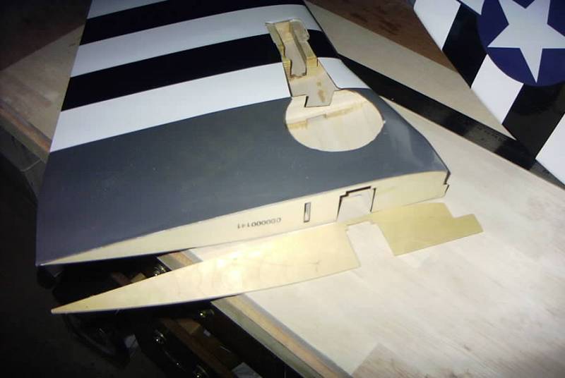

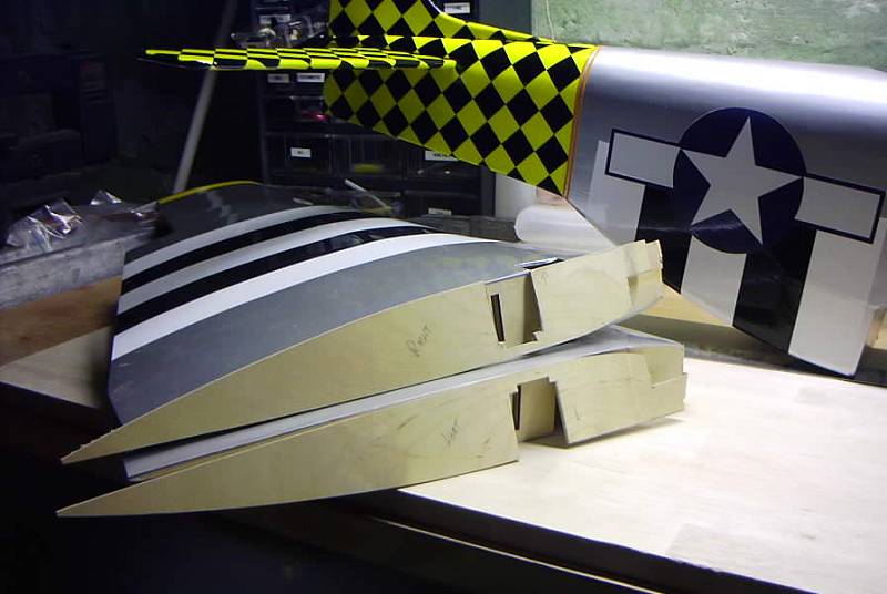

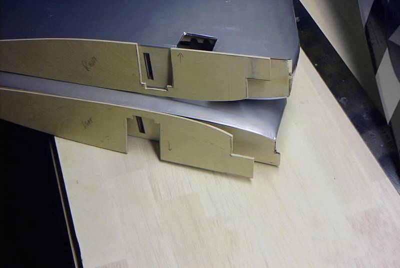

Greetings...
Well, I've posted comments about the overall quality of this particular ARF, as shipped from some country other than our own.
Notwithstanding all that, I simply shelved the airframe due to the one major challenge I could not overcome, (at that time). As shipped, both lite ply tabs on the two wing halves were snapped off at the leading edges. Since the wing is designed for retracts, no ply, blocks or other material is present to anchor dowels to attached the wing to the fuselage. I went over several scenarios but none suited me and I wasn't about to strip the wing and rebuild it.
Then it dawned on me. Why not simply cut two new root ribs from 5-ply birch and laminate them to the halves? So I did. I traced onto
3/32", cut 'em out on my band saw and sanded smooth to the wing panels.
This will increase the span slightly but solves my wing attach dilemma. Now, maybe I can finish the warbird and actually fly it. The SK .80 had been mounted on the nose for the past year, patiently waitin' it's first few drops of fuel.
I just thought I'd share this so anyone else with a similar situation due to shipping from foreign, (or domestic) lands might be able to get their airplane working again, lol...

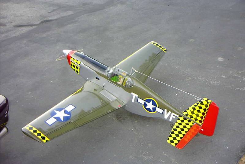

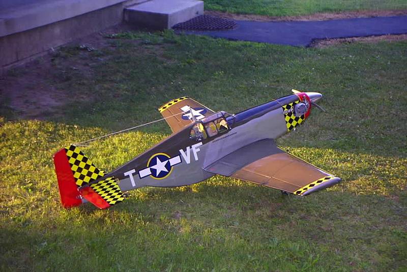

Well, here we are almost a year since my last post on this subject.
The AK P-51 Marie hasn't been a fun project. Mostly overcoming all the trials and tribulations I've already outlined. However, a buddy has needled and prodded me to complete and actually attempt to fly the plane so to keep him happy, (and off my butt, lol) I managed to get the airframe flight-ready( I hope).
Ever have a project that you, "piddle" with? Well, this was mine. I've changed so many aspects of the original airframe, (which admittedly, flies quite well as -is), I'm not sure what to expect. To be quite honest, I never thought to fly the thing, mainly just keep her as a bench queen to fill in between, "real efforts".
Anyway, I'm done. I stripped the wing filets off because I couldn't get the shape and finish I wanted so the fuselage has a lot of rippling where the fiberglass took wood along when removed. There are so many dents and dings from moving it from one end of my shop to the other over the past 2 years that she looks "war-weary" without ever seeing a drop of fuel, LOL.
I fully expect to bring it home in a bag. I'll be breaking in the new SK80 this morning but no flying until our club president is on hand to assist. he's remodeling a bedroom this weekend so I'll be messing around getting the engine settled in.
here's ehat she looks like, completed:
Have a great day!

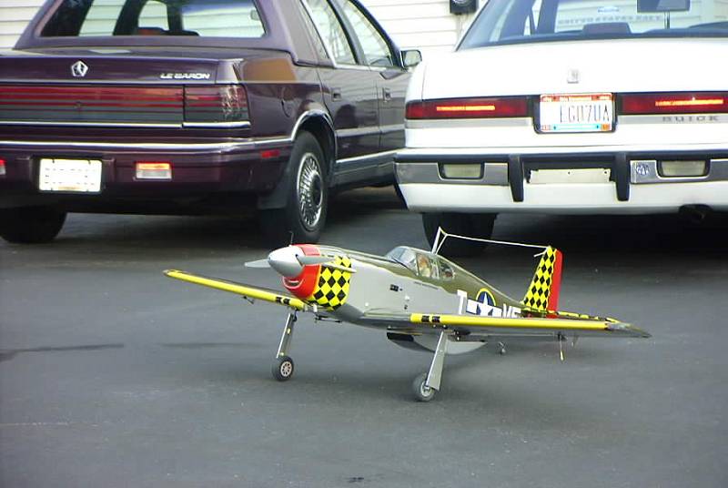

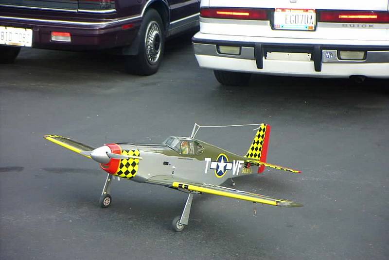

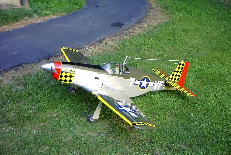

I really do appreciate the replies I've received on the thread. At 54, I was figuring that the "instant pilots" with their instant airframes were swamping out the voices of those of us that have earned our wings via balsa dust, ambroid and X-acto cuts, lol...
The SK 80 fired right up and I ran 3 tanks, 48oz, through it nice and rich-like. I tied her butt to a picnic table bench, unfolded my canvas chair and traded stories with the guys while the engine was doing it's thing. It was a GORGEOUS breezy day so not much flying was done but a lotta BS sure was floatin' around.
Keith W. has a Hanger 9 Marie, stock, so he took photos of both on the flight line. He only flew once today but it sure looks nice in the air. Hope mine does as well. Naturally, mine is heavier due to the added plumbing and the tailwheel assembly. He flys his with a 4-banger so I'm thinkning mine will scoot abit faster. Again, we'll see.
I agree with the new-engne-new-airplane advice. I've been flying my Ultra Stick (rebuilt) with a brand new ST .90. 4 tanks through it and it's still coughing a bit in transistion.
Well, it's another week waiting for flying weather again. Hope everyone has a great one. I'll post more photos as things progress to the maiden flight.

Nope. AK Models.
The engine ran fine, maidened several weeks ago but she was a hand full. CG was obviously off. No damage but I removed all the gear and hung her up for other projects.
Thanks for the feedback
