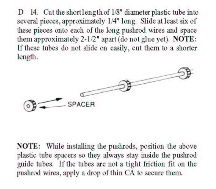

I have a Venus too, and got this weird sound too, until I change the steel rod for standard yellow nylon control rod.
The sound is "normal" on the Venus, but not good for a long time. Sound come from your 3 controls steel rods vibrating in the plastic tube. Your steel rods are 1/8" and the plastic tube not far from 1/4" round! You can replace your steel rod by standard yellow or gray Nylon control rod, no more play. Or by carbon control rod or just put some "nylon spacers" on your steel rod every 4". It will remove the rod vibration.
Check attachment

It's not really a problem. The noise and vibration comes from the engine vibration. You can simply remove the play between the guide tube and the steel rod by installing some spacers. This is a part of the problem, and removing the play it’s a part of the solution!
Engine makes vibration and it's normal. RPM variation will make more or less vibration, if you have loose parts on the airplane (control rod, for example), there is a big chance to get noise! They also noise coming from the play between the wheel hubs on the bolt axle.....
Just balance your prop, add spacers to control rod, that’s it, or remove the vibration source by converting the plane to electric!!!

Nexxa is correct. Cut the yellow innards from a nyrod into 1/8" spacers and slide them on your control rod every 6 inches or so. Rattling will stop.

Thanks for the help. I installed 4 spacers per rod and drastically reduced the noise to tolerable. Flew the plane twice today with no problems. This is my first pattern plane so I was a bit apprehensive but had no problems...
