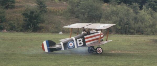

Here's a video that I did of my H9 Sopwith Camel:
[link=http://www.rcuvideos.com/view_video.php?viewkey=7c9e04fc3c89d0ede88c&page=1 &viewtype=&category=mr]http://www.rcuvideos.com/view_video.php?viewkey=7c9e04fc3c89d0ede88c&page=1 &viewtype=&category=mr[/link]
I'm using an OS-70 4 stroke with a zinger 14x5 prop. Flys very scale, and I fly it mostly on 1/2 throttle or less. I get five 10 minute flights per tank full. She flys great, but the landing, and takeoff can be a bit tricky. You must keep the wings level on both landings, and takeoff's.

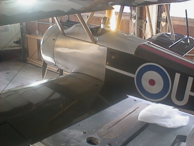

I'm picking mine up this weekend from my LHS. I have a Magnum 91 that will be used. I'll need to remember to pick up a few wood props.
This plane looks very nice with the exception of the goofy eye pilot figure. I have a civilian pilot from a GP Super Stearman. If it fits ... I'll try to modify it to look like a military pilot. Maybe some scale panel lines on the cowl.
From all that I've read ... this plane fly's very sport like. I'm looking forward to getting this built and in the air.

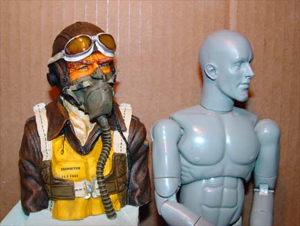

You could use the 1/5 scale WW1 pilot, He would be a little large but not very noticable. The attached picture shows a 1/5 scale Aces of Iron WW2 pilot next to a 1/6 sclae GI Joe:

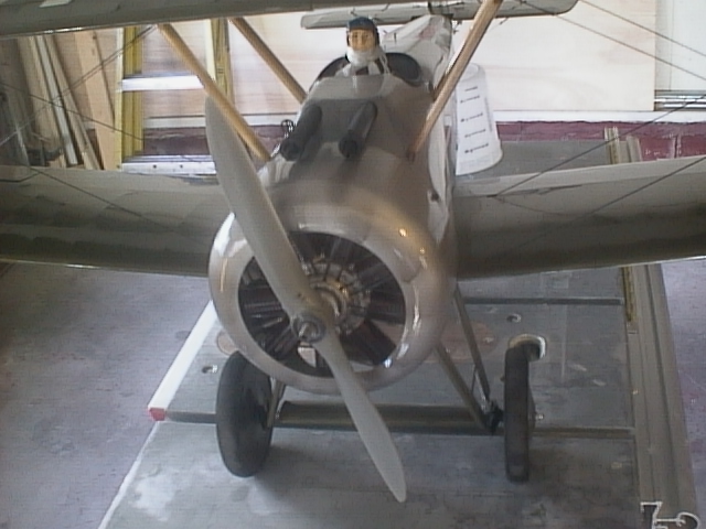

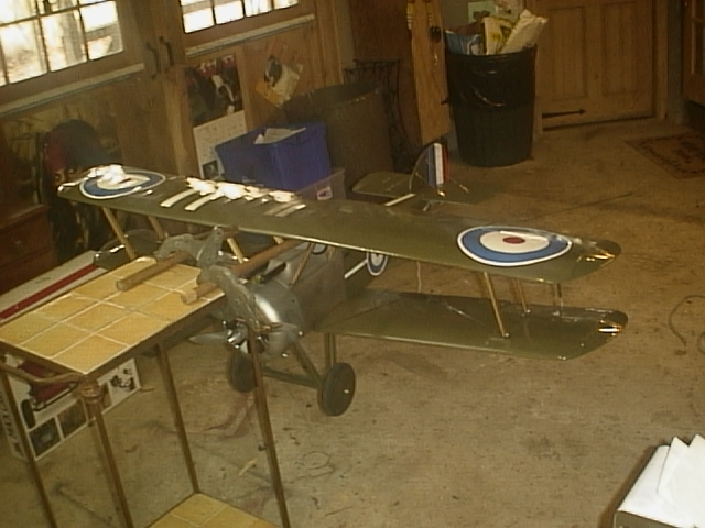

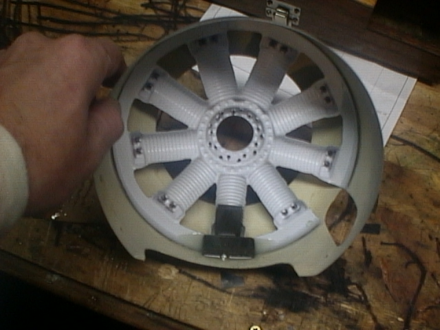

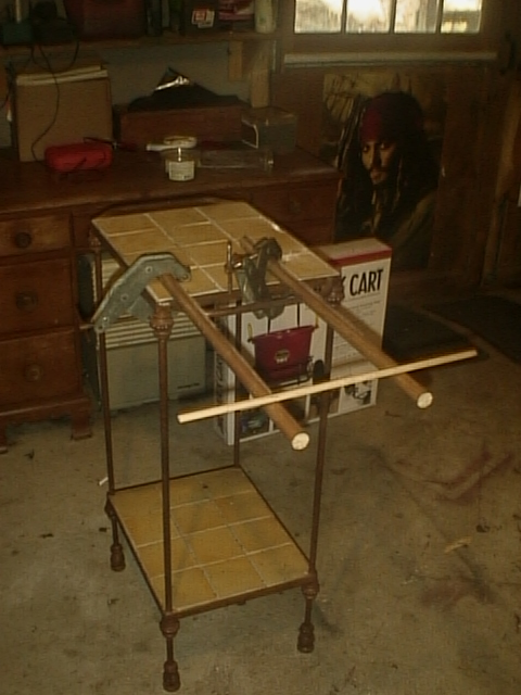

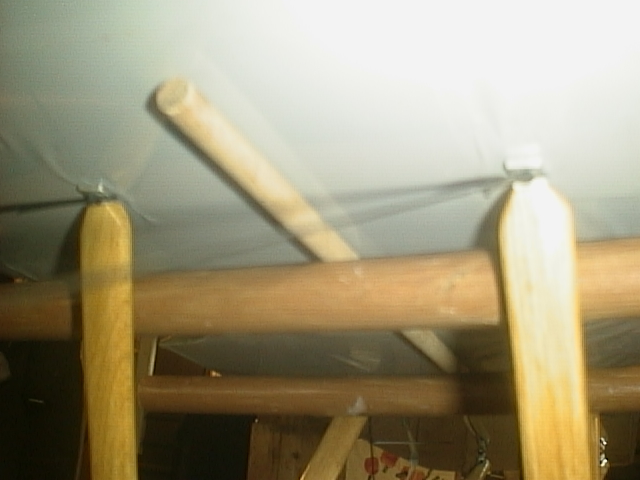

My CG stand will not work with the configuration of this plane. I set up a fairly accurate balance using two 1" x 24" wood dowels clamped to a heavy table and an 8" length of 3/8" dowel. The wing sits on the small dowel on the recommended CG. The small dowel sits across the top of the two 1"dowels. The whole plane hangs out over the end of the table and will float and balance. On the cowl I place a small leveling device and balance as needed. I'll post photos later this morning. Picked up this trick from RCU.
I'm on the nose heavy side. Used all the lead that was provided plus some glued in the cowl. I'll guess that extra weight is about as heavy as a double A battery. One day I'll get an accurate scale.
I'd rather be retentive now and not have to repair the plane this afternoon. I have a few WWII warbirds that I've tweaked enough to keep em from nosing over on a grass runway. It's habit now.
Any one check this plane with an incidence gauge? The top wing looked parallel to the 1" dowels on my balance stand and it looks like the top of the cowl is parallel to the bottom of the top wing.

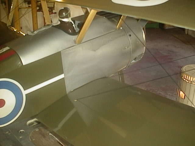

Ross, I would SERIOUSLY re-think the lead weights inside the cowl.
That cowl is made of thin fiberglass, and it's only held on with a few screws. I promise you that the combination of the vibrations of the engine, and the extra weight up front will eat large holes in the cowl where the bolts are - and the cowl will pop loose in no time at all.
Screw the weights to the engine mount, or the firewall, but don't leave them in the cowl.
