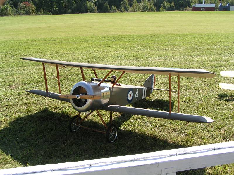

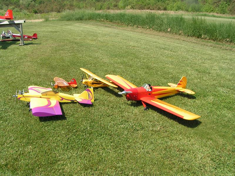

Hey Capt. Ron,
I have a Thunder Tiger Cub and Model Tec P-51 ... love them both. Did a lot of modifications to the P-51. Squeezed in a set of Century Jet retracts made for a MT 60 kit. Also added a better engine mount that extended the nose by 1/2 inch.
I fly on an elevated grass runway. As you can see ... the runway about 2 feet above the pits and can be a little bumpy depending on the time of year. You need to keep in mind that the runway is only 12 ft. wide and if I miss I'm in the tall grass. The photos are of friends.
My first take off with the Camel was all over the runway. Looked like I never flew before. Same thing happened with the Cub. You learn how to deal with it and get over with it and enjoy flying. If you have a wide grass runway and can fly and land your P- 51 and Cub I would think that you will have little trouble with the Camel.
Post Photos of your articulated Snoopy.
Rich

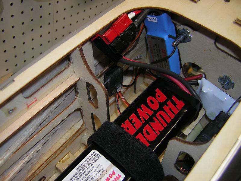

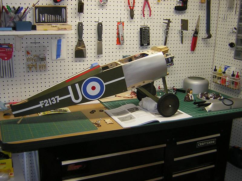

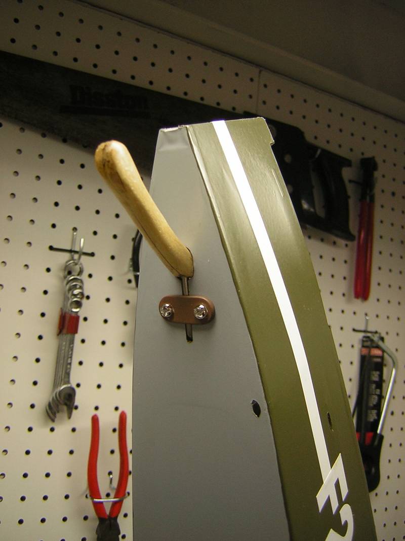

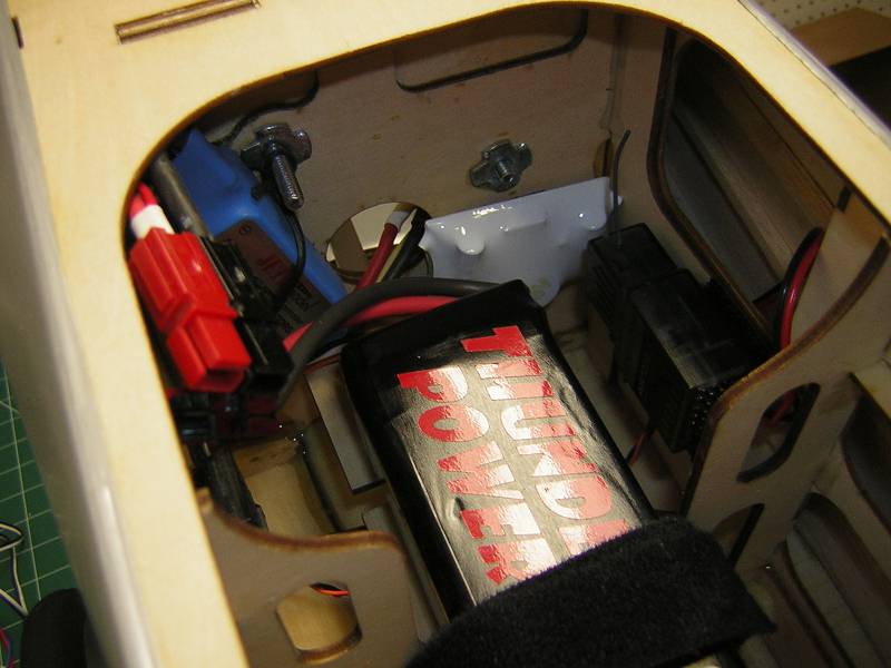

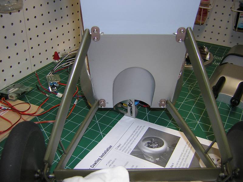

OK, it has always helped me when folks post their progress, so here are some pics that show my Camel build so far. I will be using a Power BL 46, and a sound system.
Notice I paint all my nylon fixtures a flat earth, and dull coat the covering. I will also cover the screws in flat clear to give them a weathered look. Gives a nice scale look I think. I also had to do a lot of ironing to smooth out the covering.
Electronics go in very nicely. I have the TP 4S 5000mah extreme installed, and an AR7000 receiver for the DX7. Speed control is a Jeti Opti 77 and a BEC. I use Velcro squares from Home Depot. Makes it easy to get things in and out than using two-sided tape. The speed control is also tied down with a twisty wrapped around two extra long #8-32 engine mount bolts. I did this because of all the pulling to be done while plugging/unplugging the battery. Everything is as far forward as possible.
Another note: I did not follow the manual that said to install the cabane struts in the beginning. I thought they would get in the way, and I am glad I have not put them on yet. I will do it prior to wing install.

Tclaridge, how did your CG work out on that arrangement? I would think you might need your battery as far firward as you can possibly get it, i.e. poking through the firewall into the cowl. Is the sound system mounted up there on the firewall to help?

The sound system will have a Gnome engine sound digitized from the real thing and tied to the esc so the RPMs match. There will also be a machine gun sound tied to the gear switch on the Tx, and there will be LEDs in the gun barrels so the flash matches the "pop pop pop." I don't have it installed yet, but that is next.
I don't know the CGyet, but I am assuming I will be OK because the sound system will come in about 16 oz, and its installed in the cowl. That is a good idea to open the firewall an push the battery through. It would move the battery 2 inches foward. That would move the CG forward 1/4" and every little bit helps. If I get into adding too much ballast, I will cut the firewall and go for it.
Another thing this thread helped on is I reversed the engine mount. This give more clearance of the engine against the dummy radial. I do not have to trim the dummy motor, and you do not have to reverse the shaft of the BL 46.
Thanks guys. I will post pictures as I progress.

OK, after all the good advice on this thread about weight and balance, I did some numbers and saw I was heading for a pig. I am now working to move things forward to avoid adding too much ballast. Boy is this thing sensitive to CG!!
I had to cut the firewall to get the battery forward, and most electronics will go under the cowl (except the Rx). I am posting a little Excel sheet to share my weight and balance. I hope it may be useful for other folks to plan their radio, motor, and equipment install. For us electric guys, the lighter motor seems to create a balance challenge.
I will post pictures of the final installation when it is done.
