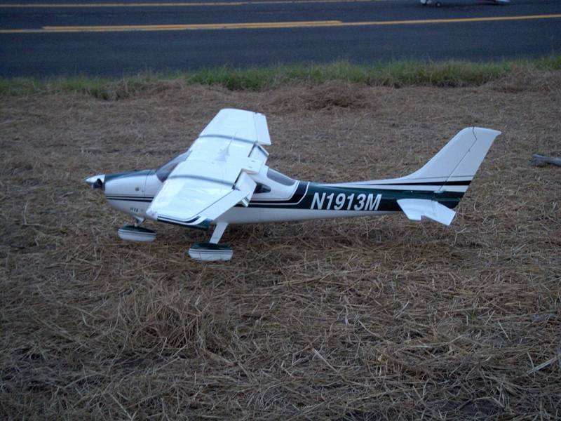

Here is my .50 CMP Cessna Re-painted and added some mods Like fowler flaps,cowl flaps, landing and nav lights and replace the stock wheel pants for the Great Planes Cessna ones. They look more scale to me. Here is link to my video.
http://www.youtube.com/watch?v=RtKova1p95E
http://www.youtube.com/watch?v=I9yFToeY1iE
Old 11-24-2008 | 07:53 AM
  #173
roly1129's Avatar
Joined: Jan 2008
Posts: 228
From: St. Cloud, FL
Default RE: NEW CESSNA 182!!
Here are a few pics.
