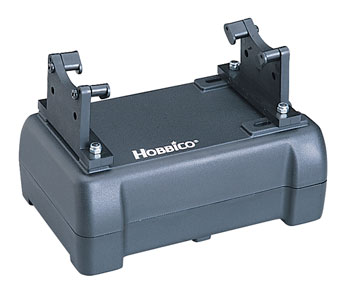

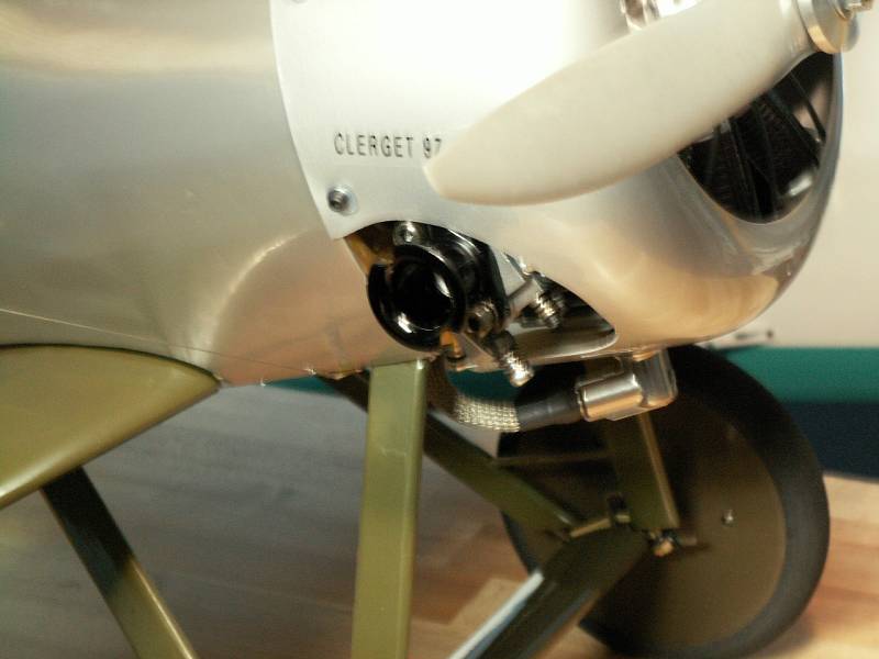

does anyone have a hangar 9 electric starter? Is there an easier way to conect the starter to the battery other than just hooking the clamps to stripped wires?
#479
CGAMT: Not sure what you mean without a picture. I use this battery pack. The wires from the starter run down to it, and the starter straps onto the little cradles. Eliminates wires that can get caught in the prop, and is only one thing to carry instead of two.
One thing with any starter battery setup, as you mentioned bare wires. If there are any bare wires anywhere between the battery and the starter, other than the clamps right at the battery, you have a major disaster waiting to happen. If bare wires connected to a 12 volt battery touch each other, they will throw the battery into high rate discharge, it will get hot real fast, and quite likely catch fire or explode. A twelve volt battery is a very dangerous item, and should be treated with great care.

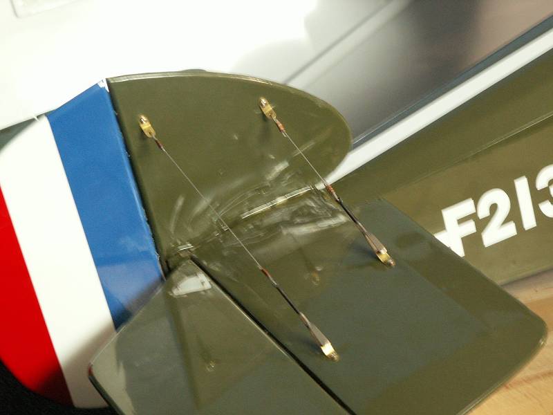

I intend to use Pull-pull for rudder and elevator. I'll replace the tail braces with carbon fiber cords and no metal fittings. That, I hope, will reduce the tail weight enough so that I can get to a 3.75" CofG without the lump of lead.

Finished my plane too bad it will be a while before i fly it. About the starter question here is a picture you requested. See how the wires connected to the starter motor look like jumper cables for a car and the exposed wires coming off the battery? The directions for the starter were not that specific all it said was to strip the wires and connect the motor.
Jeremiah
Jeremiah
#487
Jeremiah:
You need to use crimp type butt connectors to connect the short piece of wire w/connector from the battery to the starter. (You'll be cutting off and discarding the clamps.) Black to black and red to red. If you don't have the tools or knowledge to do this, take it to an auto parts store and they should be able to show you what to do and sell you the equipment.

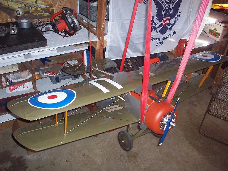

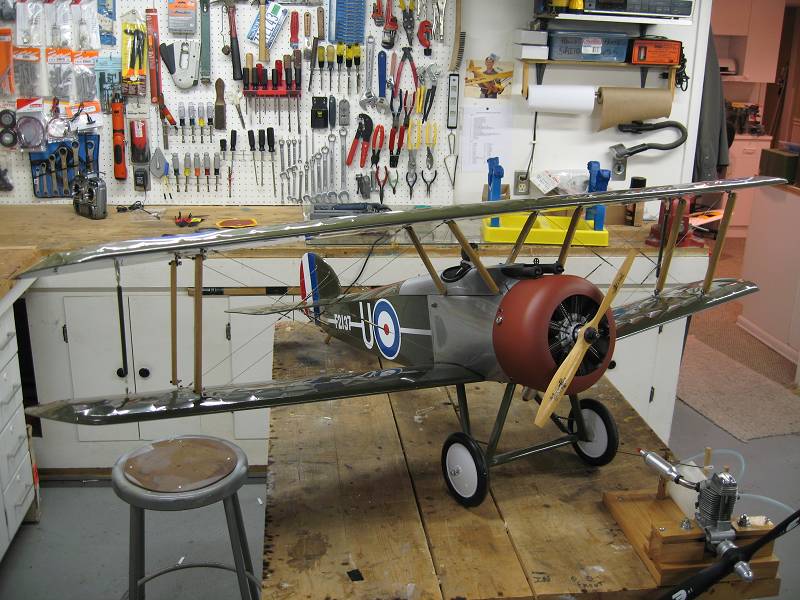

Got one for my birthday. Finally got it finished and fired up. It is a great looking little airplane. What has me intrigued though are the number of rookie pilots who met their demise attempting to fly this beast. I love flying the Gee Bee Racers and this Big Pup sounds as if it is right up my alley.
[img][/img]
[img][/img]

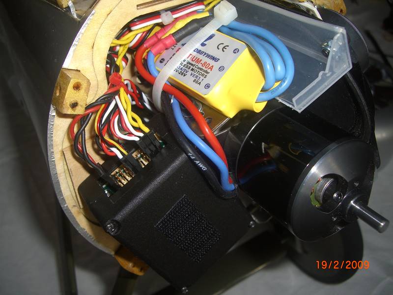

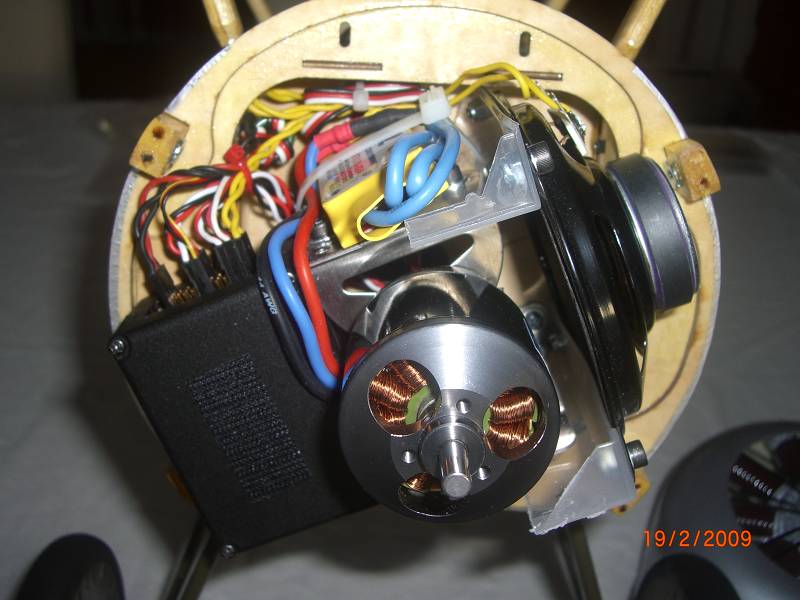

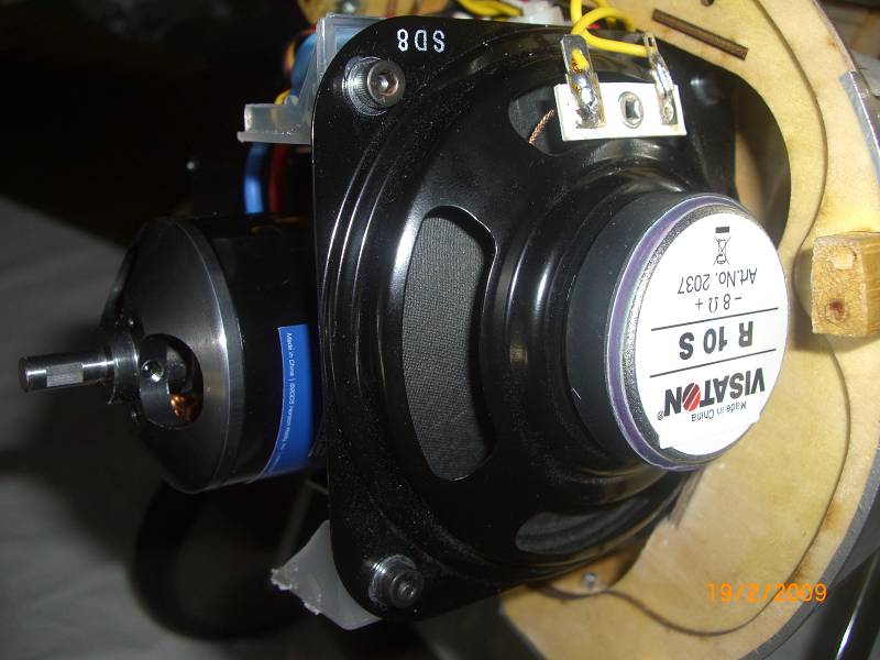

Well I finally went with the Eflite Power 60 electric motor and managed to get the cowl distance right by reversing the front on the engine mount. I had to elongate the slots slightly to get the E60 far enough back and then I put four extra bolts at the rear of the slot to make sure it was really solid. This gave me a nice platform to mount the sound system. You can see from the picture I put the 4inch speaker on the engine mount held on with two 90degree plastic mounts taken from an old cut up cassette box. The speaker just fitted in nicely and missed the cowl. The ESC is on top of the mount with the speaker system amplifier and control electronics mounted in a receiver box held on the other side of the speaker. I may put the receiver batter on top of this (2 cell Lipo) if I need to get the CG further forward. At the moment the receiver (2.4GHz) and BEC are behind the firewall. I will carry on building but thought you might like to see initial efforts. Thanks again for the advice.
