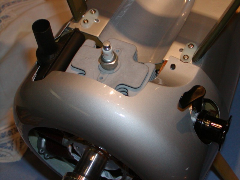

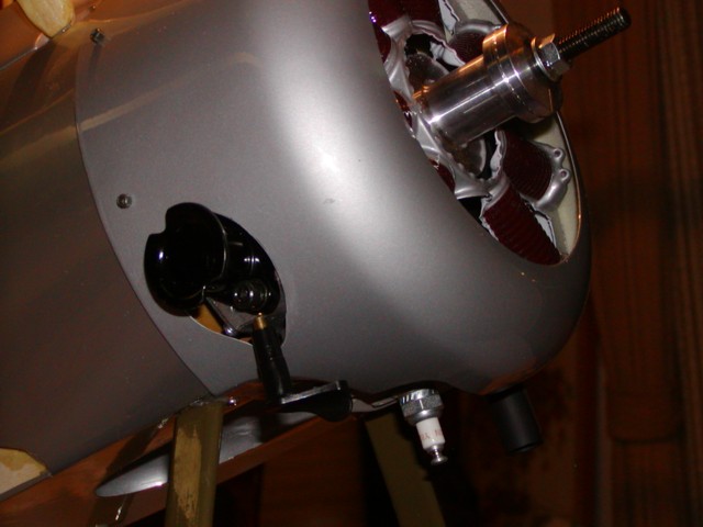

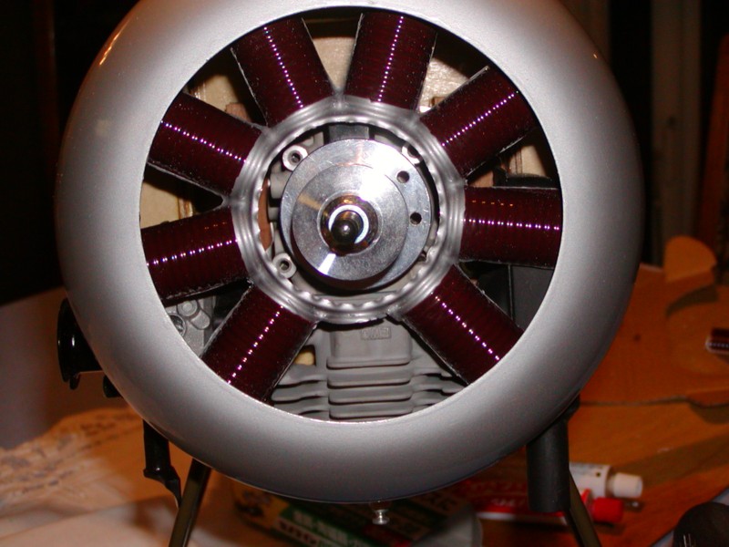

I managed to install G20 with 1" stand-off wood.
I didn't like, but I had to cut out a lot of the center of the dummy engine
which ruined the dummy push rods, otherwise I had difficulty in installing
the cowl because of protrusion of the velocity stack and the muffler.
Tsutomu Mabuchi

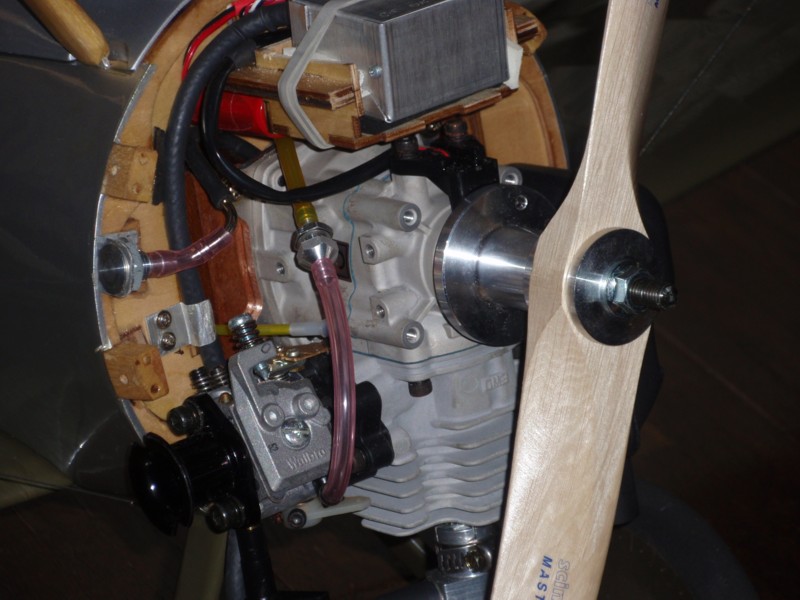

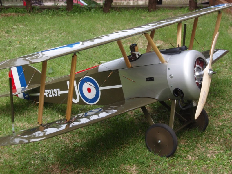

Finished the building. I was impressed with this ARF's very high quality for the price.
The pre-made rigging wire, fiberglass cowl and upper fuselage pan, shock absorbed
gear, pre-installed linkage rod tube and receiver antenna tube are precise and solid.
Only one what I want H9 to change is aileron installation. The original hinging is very
hard to bend upward. I cut and reinstalled them with PP hinge.
It needed no weight in the nose.
Tsutomu Mabuchi
