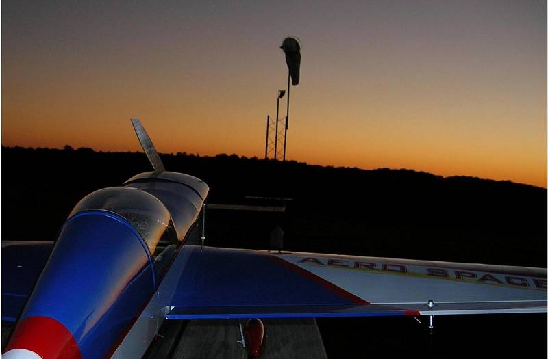

Got to field today finally with great weather. Here are some pics. The .75 was great. Not a rocket pullout, but it will hover...so I'm happy. 3D was great just watch that elevator like TOC said. I had to drop my rates down a little on the elevator because it wanted to snap a little going into a wall, but after dropping the rates it just stayed there and would hold beautifully. I am very excited about going to the fly-in tomorrow at the field.

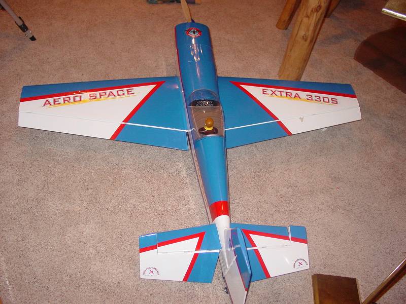

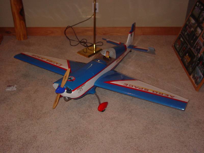

Ok finished mine today. Here are some pics.

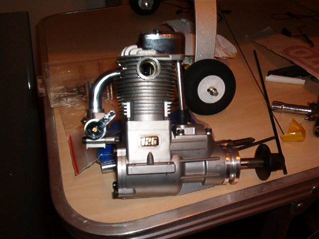

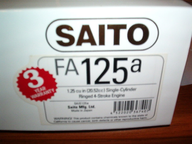

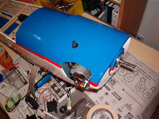

I was originally going to run a OS 91FX on this plane, but picked up s good deal on the Saito 125. So I am going to have a low time good running 91FX for sale cheap!
I think I will move the blind nuts and mount this horizontally on the plane, hopefully make the engine a little more user friendly. I have never been a big fan of inverted 4 stroke installs.

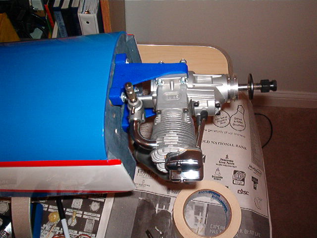

Engine mounted and cowling cut!

Geez you had to butcher that cowl! Oh well hope that Saito 125 does well. Vertical will be insane!!!!
