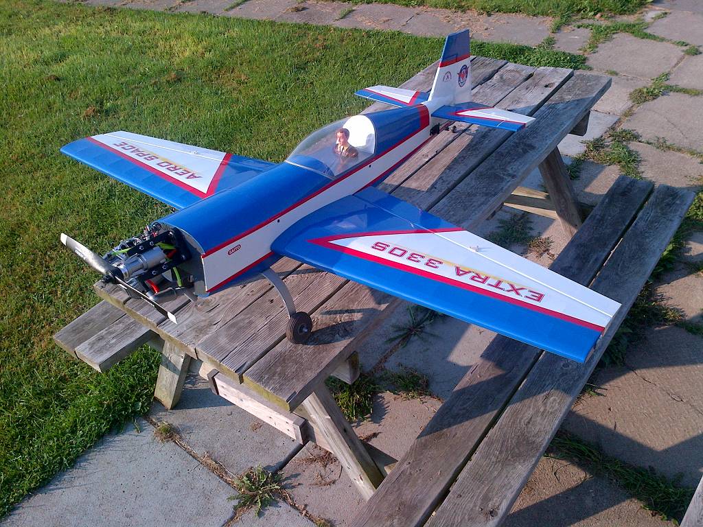

Old 08-28-2012 | 12:00 PM
  #1903
rmsingh's Avatar
Joined: Jan 2010
Posts: 43
From: Pickering, ON, CANADA
Default RE: Pheonix Extra 330S 60-90 Size
A friend of mine maidened this baby for me last saturday[img]C:\Users\SinghR\Pictures\IMG-20120825-00006.jpg[/img]. With a Saito 100, she hovers at half throttle (engine not yet broken in). I'll have the cowl cut and ready to be installed by next week, I just need to have the engine tweaked a little.

Old 09-03-2012 | 05:42 AM
  #1904
BilleFly's Avatar
Joined: Oct 2010
Posts: 63
From: Las Vegas, NV
About how long does a tank of fuel last with your Saito 100 ?
How big is the tank ?
Bille
Old 09-03-2012 | 10:34 AM
  #1905
rmsingh's Avatar
Joined: Jan 2010
Posts: 43
ORIGINAL: BilleFly
Bille
Right now, I get about 7min on a 12oz tank with it set very rich. I only have 1 flight and 3 tanks [on the stand] thru it.
<br type="_moz" />

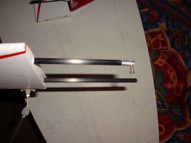

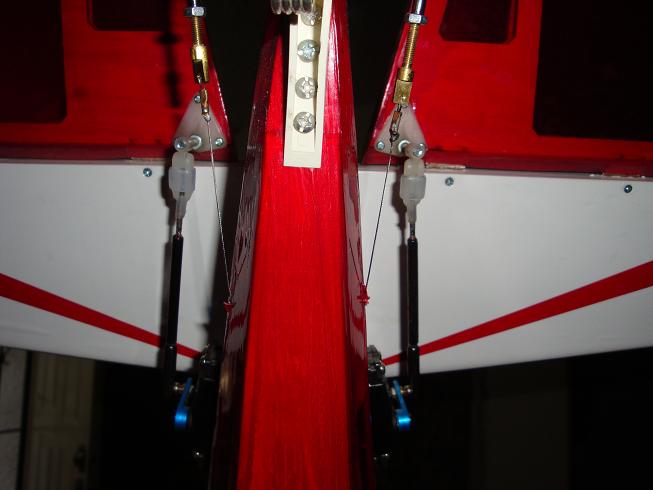

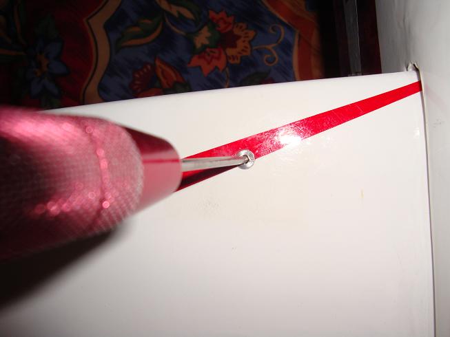

Old 03-19-2013 | 05:03 PM
  #1913
BilleFly's Avatar
Joined: Oct 2010
Posts: 63
From: Las Vegas, NV
Ameyam asked me to show him how i made my horizontal tail fins removable.
I wraped the carbon with some wax-paper, then wrapped some Glass &amp; Epoxy around
it.
Cut the new glass tubes as supports for the carbon that is glued into the tail-fins.
Cuts down on Hanger-Rash when transporting ...
Only added a little weight ; but it was Needed for the DLE-20 anyway !!
Bille

Old 03-19-2013 | 05:26 PM
  #1914
Joined: Sep 2008
Posts: 2,224
From: Mumbai, INDIA
Hi,
I get it. But how did you make holes in the tail stab to take the CF tubes?
Ameyan
Old 03-19-2013 | 09:00 PM
  #1915
BilleFly's Avatar
Joined: Oct 2010
Posts: 63
From: Las Vegas, NV
I Built , No "Re-built" the stab around the carbon tube.
I put the inserts on the one with holes by placing the glass tubes
on the carbon first. Use the glass tubes that go through the fuce
as spacers when modifying the new stabs.
You Could secure the stab(s) to the side of the fuce with a 90deg
angle aluminum, instead of the screw in the end of the carbon tube.
Probably be easier, but you would need Two of them ; one for each side.
Bille
