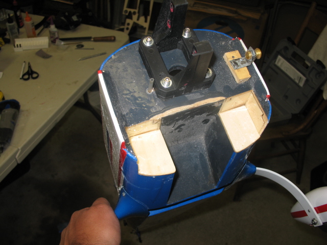

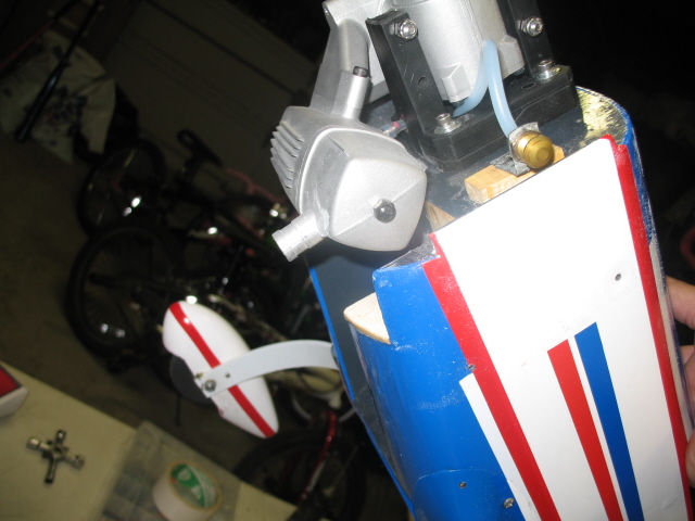

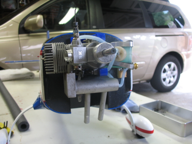

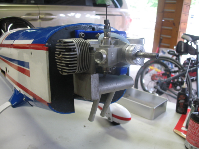

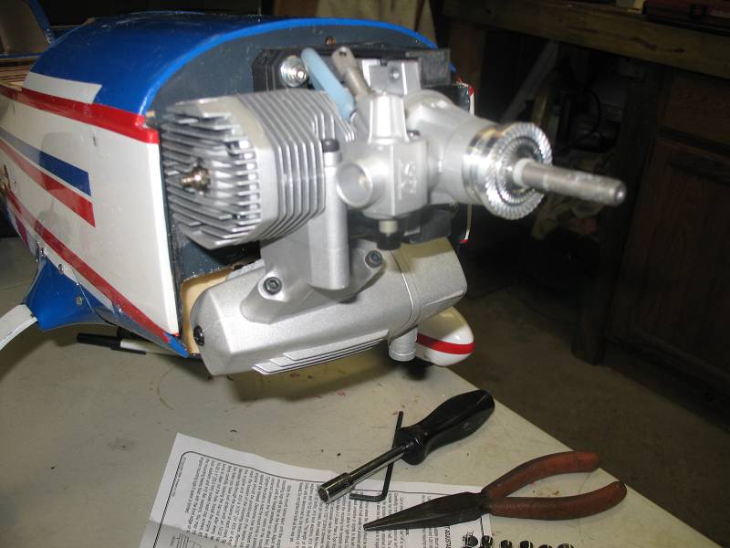

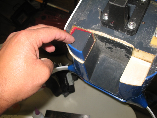

So the work is done. The 1.20 is in!!! I took a few shots for comparison's sake between the .90 and 1.20. As you can see it needed a bit of firewall modification to fit the ax muffler. I have had good luck on my edge with the muffler so I didnt wanna throw down another $60-$70 on a pitts muffler that I didnt feel was needed.
Balancing this monster was a bit of an issue, I ended up with the 5 cell AA rx pack in the tail.... I mean..... if it was any farther back it would be in the rudder. I actually installed it with a bit of surgery. I opened up the bottom of the fuse between the tailwheel block and the elevator servos, and pushed in some foam and stuck her in. I capped it off by ca'ing the original piece back in and then covered it up with a scrap of blue I cut out from behind the canopy.
I ran a break in tank thru her in the yard this evening. The next chance I will be able to get to the field to try her out will be tuesday. So no maiden report till then!
Im just glad I got it in finally!!!

That thing has got to be just "NUTS"[sm=stupid.gif] with that 1.20 in the nose. I sure hope you have the chance to shoot and post some video. Let us know how it all goes.
#1011
Joined: Jul 2006
Posts: 2,819
From: Ossining,
NY
Insane power![X(]
Make sure the control surface linkages are rock solid because terminal flutter is just a flick of the stick away.
And be wary of rudder wag as well. Even with a strong rudder servo and pull-pull cables tight as banjo strings it can still happen. Consider bracing the rudder servo mount.
Looking forward to the flight reports.[sm=spinnyeyes.gif]

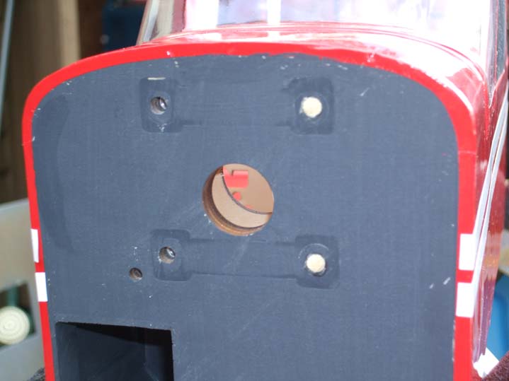

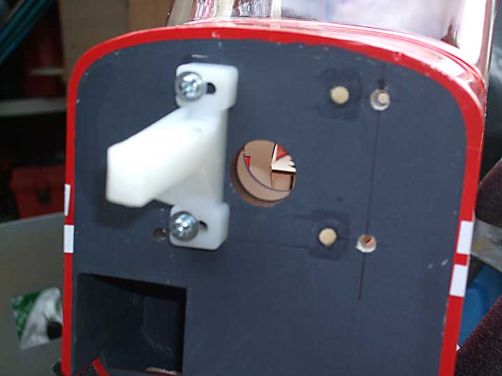

Having trouble getting the motor mounts from Tower for my Phoneix Ertra 330s 60-90 Size. The plane came with all type
of problems in the box. Tower has been good about replacing the damaged parts. Now I have found that the plane was
shipped to me with two left motor mounts. I tried to get them to sell me the hardware for mounting the motor. They say
that they do not sell this hardware. They told me they would sent me one from another Phoenix extra 330S ARF. They
did so, but it is not the one that came with the ARF. To use it I would have to do a lot of changing and fitting of this to the
firewall. NOT A HAPPY COUSTOMER. I told them at Tower, I should have this plane finished and flown it and CRASHED by
now !!
Has any body elese had this type of problem with this ARF??

So heres what Ive done. I fueled up the plane (since thats where it flew good) and marked the cg. I then drained the tank, moved it back 3 1/2 inches to the wing tube. Then I brought the battery foreward to set the cg where it was marked with the tank full.
I hope I can get by with having the tank farther back without causing a lean condition. I opened up the pressure nipple on the exhaust as far as safely possible. I also ran 1/8" line for the pressure line. I believe the 1.20 makes good enough pressure to push the fuel another 3 inches, but I guess we will see.
I hope to do some more test flights on friday, so I can have some fun with her this weekend.
I'll keep you posted.
I always set my cg to factory specs initially. This plane is no exception. The BIG difference is that I added the header tank AFTER balance. Thats 2oz of fuel in the nose that never went away. I also never ran the plane past half empty. Id have to fly it for 15-20 minutes to suck a 16oz tank dry with that .90.
So the cg must have been far more foreward than I had thought. It used to land dragging the tail a bit, but I think the extreme difference in fuel and cg point made all the difference in the world as to how it flies now.

The cg is currently at 4 1/8". This is 5/8" foreward from factory spec. When I fill the tank in its current location it moves only about 3/16 inch foreward.
Another quick note.............when I removed my cowl last nite to run the new fuel line, I had to also remove my needle valve extention. So I counted how many turns open I was before removal. AMAZINGLY it was only 1.5 turns open. I KNOW it is filthy rich at this setting, because I could see my smoke trail well against a cloudy dark sky. And it sucked that 16 oz tank dry in 10 minutes.
Its been my experience that usually a rich setting is more than 2 turns, up to 3 before it starts to four stroke. So knowing this, it is my speculation that the 1.20 develops alot of tank pressure, hence the 1.5 turns open.
So I believe (and hope) that the 1.20 will develop good enough pressure to deliver the fuel another 3 inches properly. I will do some nose high testing on the ground before I make this assumption though............. and AFTER I get a few more break in tanks through her.

ORIGINAL: wingboz
Guess NO one has had a problem like I aks about earlier.
I should have this plane finished and flown it and CRASHED by now !!
Wingbos
Wingbos
You're statement Guess NO one has had a problem like I aks about earlier. would be correct based on my experience.
But sometimes different things happen. Sounds like Tower is trying to make you happy. Drilling 4 new holes and moving the blind nuts is not a big deal for me. I certainly figured out how to crash mine faster than I could assemble it. [&o]
Good Luck, I hope it all works out for you. We'd love to read about your build and flight set-up.

wingboz, like Rick said, sorry to hear about the motor mount issue, but it really isn't that critical to have the exact motor mount.
In fact, I usually put the engine in a different position than that depicted in the instructions, so I often use different mounts. The model is none the wiser.
It's easy to knock the blind nuts out and re-rill. Just thread one of the bolts in and tap out the blind nut. To fill the hole, I often use a chopstick (rom Chinese take-out orders) and CA it into the old holes, cut off with a razor saw and re-drill the new holes, per the photos. The pics are from a Seagull Super Decathlon, but the prinicple is identical.
