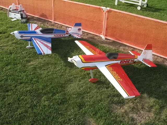

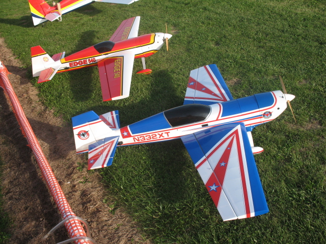

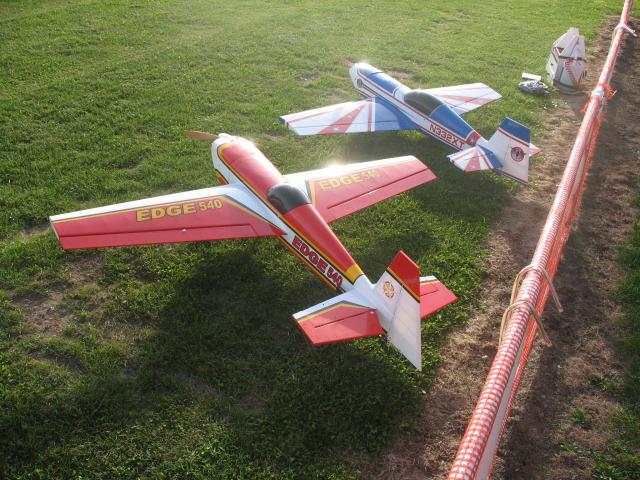

Heres a couple pics of the extra and the edge. The engine shown is the 1.20 on the edge. Im anxious to get this thing back in the air!
One more thing. My cg seems to be good where it is at..... where does everyone else run theirs??

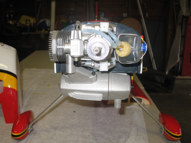

My Phx extra with the sk .90 still has a header tank. The purpose is to keep a clunk submerged at all times. I was intitially having alot of running issues with the sk... but after a header tank and blocking off one of the pitts muffler pipes, it runs great now. The motor just needs to be on a 6lb plane... not an 8lb one....
I wont be using the header tank on the extra once the 120 is mounted. I have YET to have a deadstick with that motor on the edge. Through hard aerobatics and all.........I just love that motor. I will be swinging a 16x6 on it.

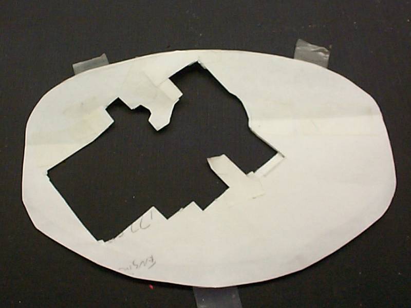

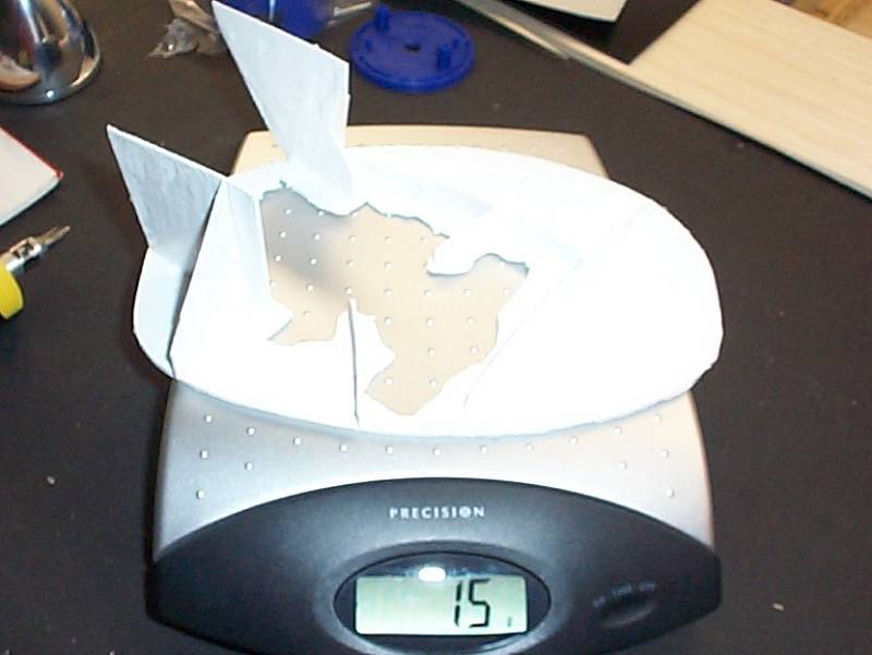

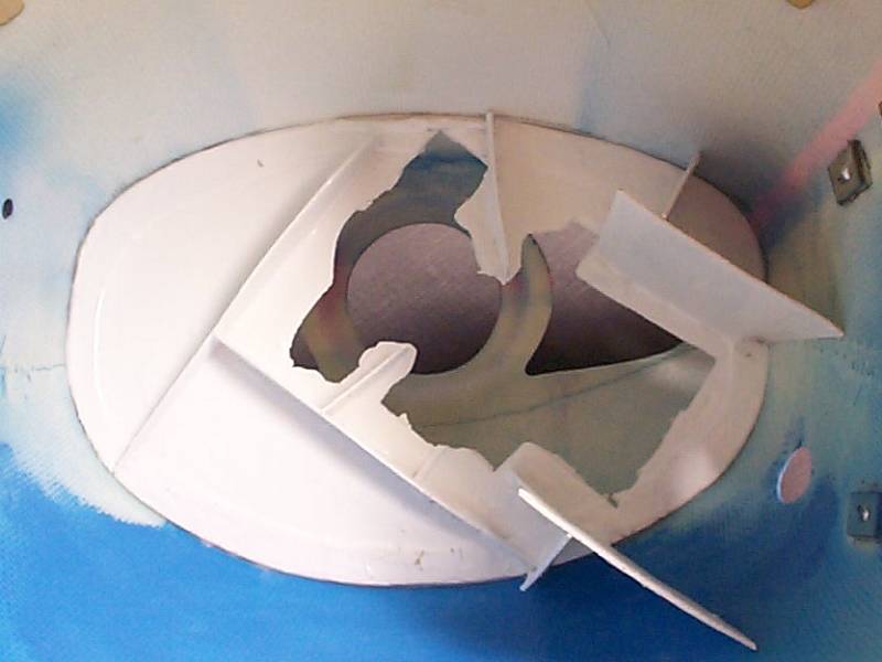

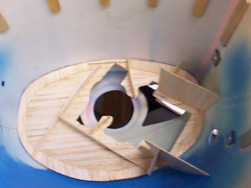

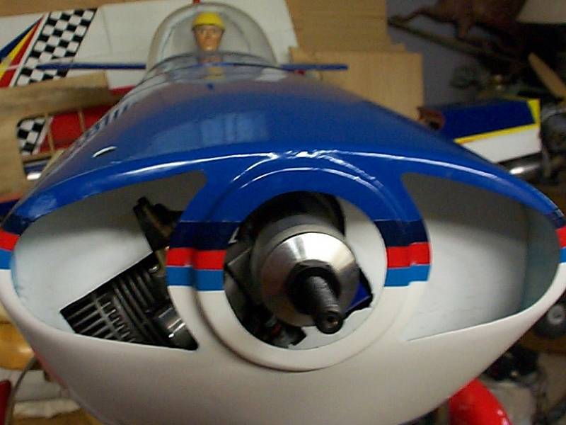

In order to keep things in chronological order, here is some baffle work I did on my extra Wednesday and Thursday.
With trial and error fitting I made a paper template to fit in the cowl just in front of the fins on engine cylinder. Once I was happy with the fit I cut it out of 1/32 balsa. I used some pieces of the same to create doublers around the edges. A couple curved pieces across the middle and a couple of air damns running down the sides of the cylinder. Sealed with 5 minute epoxy and painted with Top Flight Luster Coat. Weighed in just over a half ounce.

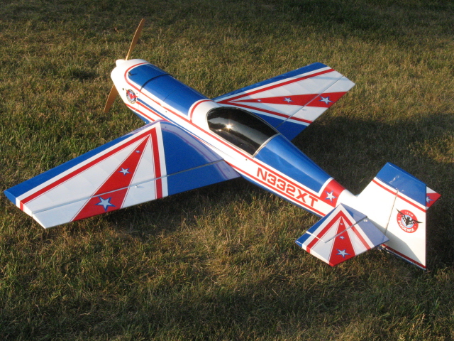

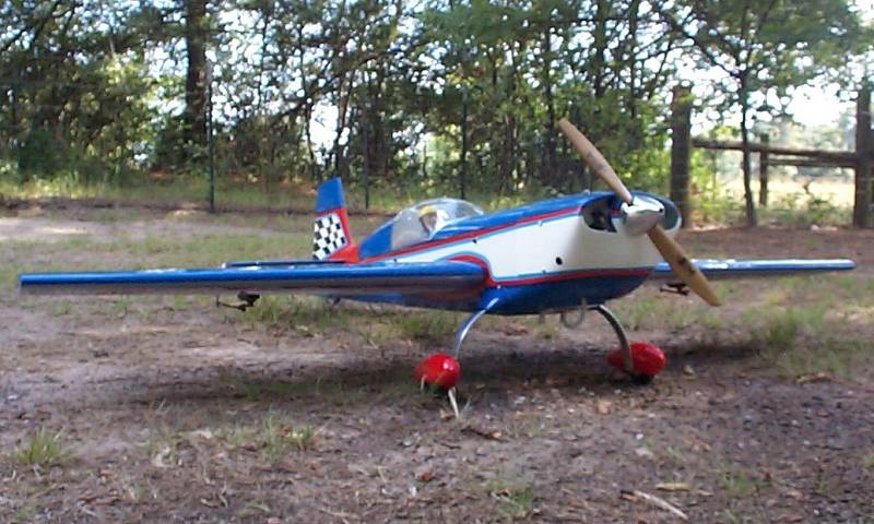

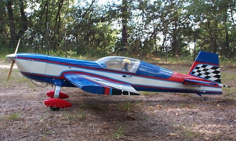

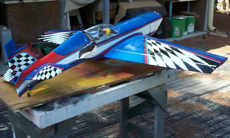

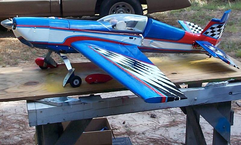

Here are some shots of the "Extra" just before leaving for maiden. My wife tried to do some video for me. I will see what I have next. It is an analog camera so I have to import edit convert bla bla bla.
I managed a couple of typical non event maiden flights. Still running rich with a 14X6 prop and I will have to adjust the throttle linkages. All in all it was good. I am happy with the small amount of positive incidence that I added to the stab. Only a small amount of down trim required for level flight at half throttle. Which is the same at full throttle on this plane. Damn thing lands nice for me. Cut the throttle and it settles in to a nice descending glide path.
Muffler sounds different. But still doesn’t make it sound like the big boys. Maybe once I get a little more time on the engine and switch to the 15 inch props maybe it will sound a little better.
