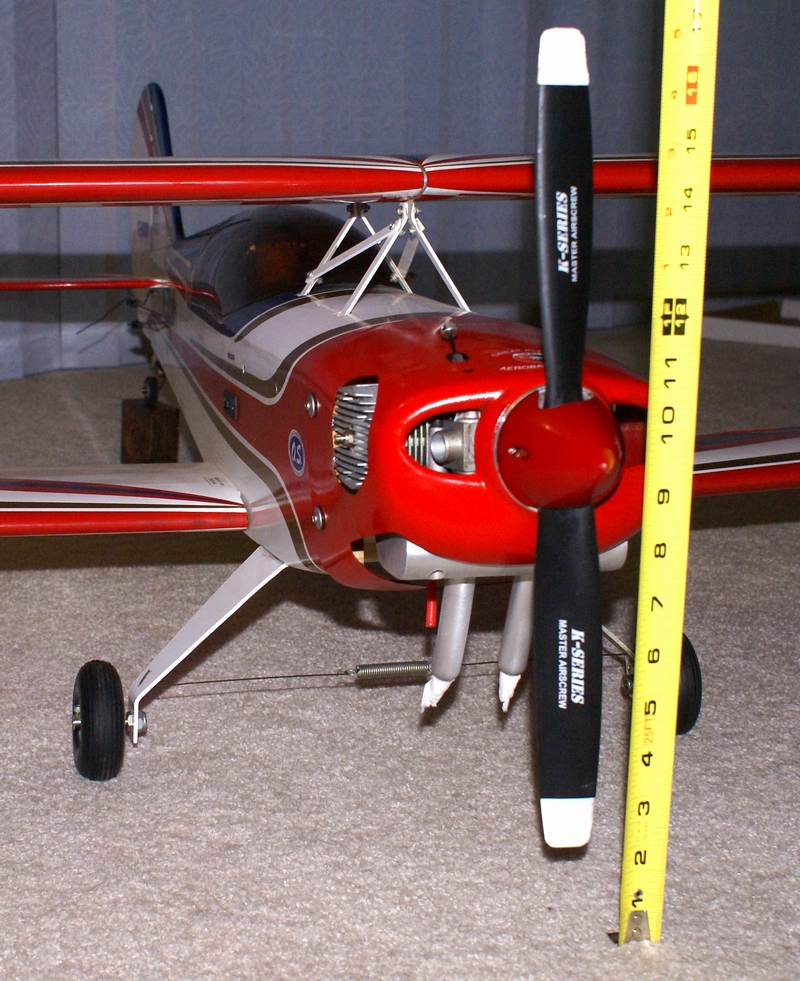

There you go. Note the tail wheel is 3 inches off the ground. I use a spring and piano wire set up on the landing gear to make sure the gear does not splay out in the event of a hard landing.

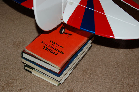

The included pictures show the clearance a 13x6 prop has when the GP Skybolt ARF is parallel to the ground as it would be when touching down in a 2point landing or as it would be after rotating on takeoff. Please note the stack of books that were used to "level" the airplane.
I carefully selected each one in order to more accurately elevate the model and the level of this thread.
The steel right angle ruler was used to show that the prop was perpendicular. The measurement actually will err on the long side, since the ruler pressed into the carpet more than the tires of the airplane did.
As the pictures show, a 13" prop on the ARF Skybolt would have about 2 1/4" clearance. A 15" prop would have about 1 1/4" clearance. Those distances would be accurate off paved runways and would suggest how your prop would clear relative to the depth of the grass on your field.
It's clear that you fitted your landing gear with spring/piano wire, but it also looks very much like either you bent it as well, or your ARF came with taller gear. No wonder there is confusion over the clearance.
Thanks for your picture. It fills in the details about your advice. BTW, your first picture of that Skybolt in the grass seems to show a Skybolt with wheel pants and the stock gear legs. Your last picture shows the modified gear without the pants.
I wish one of us had had the time to include pictures early on in this thread and it would have been a shorter, better thread.

It can all be made to work with very little effort. The gear as shown with the plane in the grass and the plane on the carpet have been in the same configuration since day one. The wheel pants were removed since the first picture to repair some cracks that developed from always landing on grass. I do have three inch wheels from the normal 2 3/4 inch that come with the ARF.
Good deal, we now have two pictures that illustrate why little details make or break advice.
The attached picture shows a Skybolt that's completely stock, right out of the ARF box. It's been jacked up in the rear so that the prop is square to the floor. It's got the suggested propeller on it for one of the suggested engines. The prop is a 13" prop and the engine is an OS61 and the spinner is the one that came in the ARF box. (Pay no attention to the person behind the curtain holding the tape measure.)
One magazine always reports a special measurement when they do ARF reviews. They report the prop shaft to floor distance. That gives readers a feel for how big a prop the airplane can swing without cutting grass or chipping off on the pavement. If you look at the attached picture the tape shows that measurement would be just a bit over 8-1/2" for that ARF as it was assembled with the components that came in it's box. If you look, you can also see the angle of the unmodified stock gear legs as they come from the mfg. Keep in mind that gear flexes on landings and usually flexes a bit less on takeoffs, depending on how bumpy the runway is.
That setup gives that prop about 2" of clearance to a tile floor.
I've got a couple of airplanes with that prop clearance over the pavement runway at one field. When I fly them at the grass field, they start to turn green. The last few days, they've also been turning the color of red clay. They've been shattering dirt plugs that're scattered around in the grassless places that're all over that field. You always need to take your flying conditions into consideration when deciding on prop clearance. And a LOT of other small details.
Hope all the pictures and discussion have covered most of the important details and this was helpful.....
