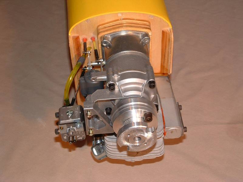

Both these planes look beautiful, some of the things I am concerned about is how difficult it is going to be to mount the G62 in either plane. I have a G62 that has been converted to EI and with a Slimline pitts muffler.

I have exactly the same combination in my Sundancer. As you can see from the pictures, the installation is very tight. I even had to cut off 1/4" of the muffler on the exhaust side and weld on a new end cover to keep it inside the cowl. I also had to move both sub-C size nicads to the rear of the airplane for balance. On the other hand, performance is excellent and the engine runs like a watch.

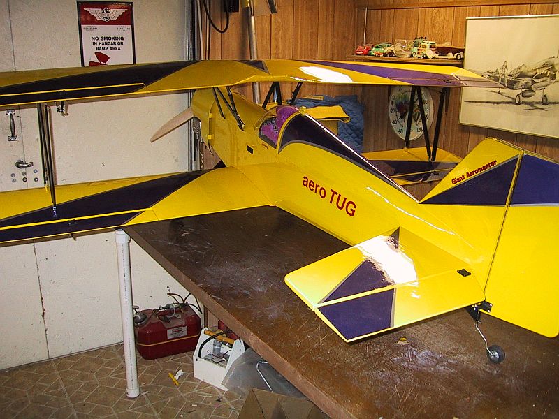

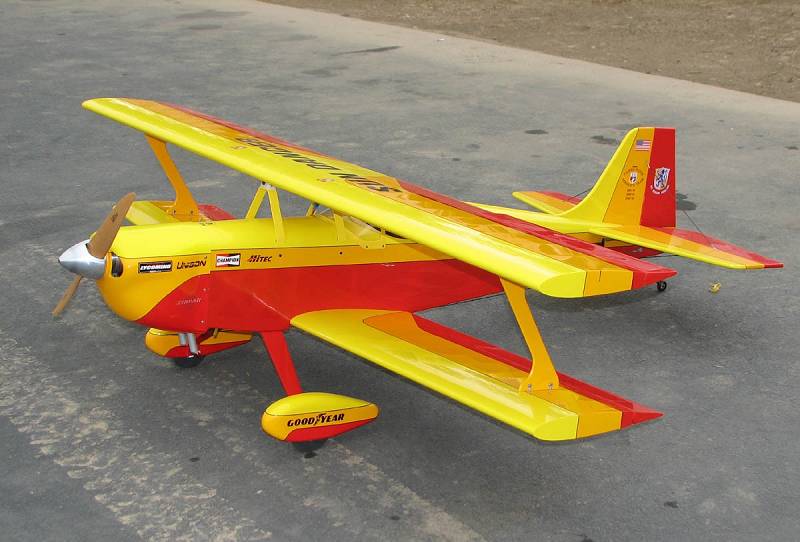

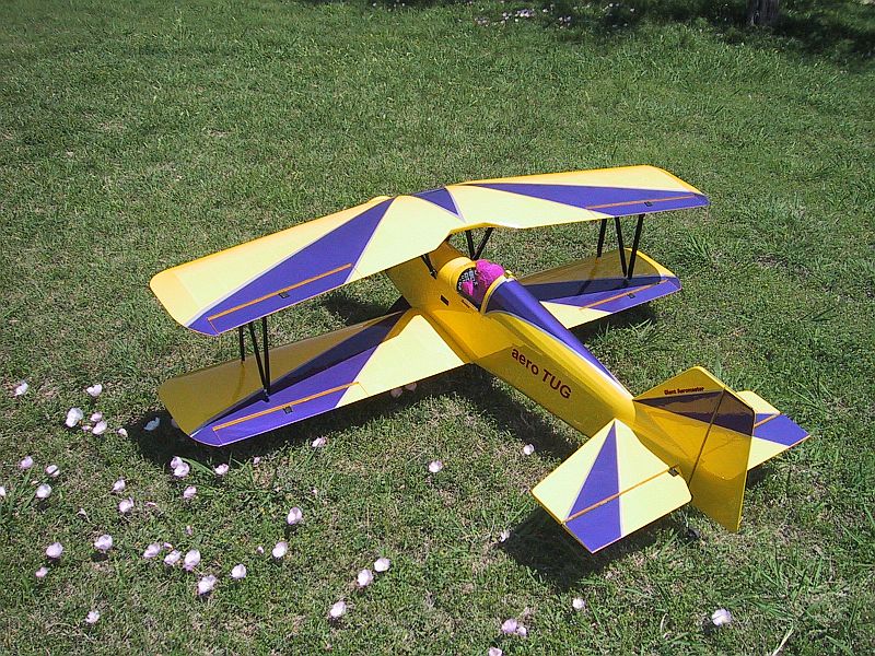

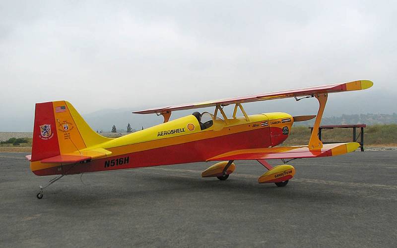

Old 10-17-2006 | 07:45 PM
Big_Bird's Avatar
Posts: 4,258
Received 7 Likes on 7 Posts
From: Arlington, TX
Default RE: G62 IN A BIG BIPE
The G-62 is one of the most popular engines used in the Great Planes Giant Aeromaster and, yes, you can still use the cowl. My GA weighs 21 lbs and is a real hot rod. I highly recommend the G-62. I have had many aerobatic biplanes and the Giant Aeromaster is the best flying of the bunch, hands down.
Here are a few photos.
