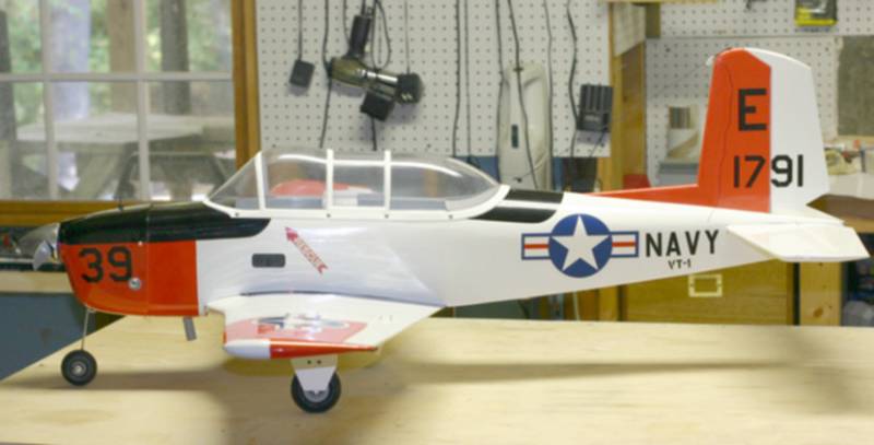

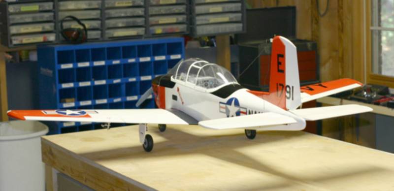

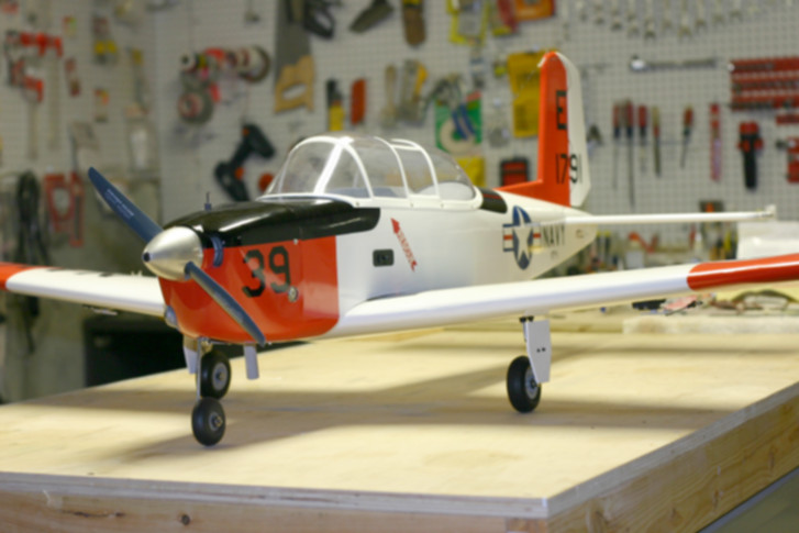

I completed the assembly of the new T-34 a couple of days ago - the kit went together very well and all the parts fit was first class. This kit had the black (walkway) trim on both sides of the wing and this should be removed from the bottom before assembly if your kit came this way. The wing assembly and retract installation was relatively easy (reminded me why I like air retracts) other than the fine tuning and wire bending to get the retracts to lock on each end and move easily.
I installed the Evolution 52 in this one and other than the extra hole in the cowl for the front of the muffler I really liked being able to use the stock muffler and not add another $40 for a pitts.
Balance was easy and done with the battery located just behind the servos.
The wind should be down tomorrow - I'll let you know how she flys.

This is a training plane, and with a cadet and instructor on board, this would look real good in the air!

Four two flights on Sunday and two today - it flys like it's on rails - lands a little fast compaired to most arfs, but like a trainer compaired to a giant scale warbird. Couldn't find any bad habits - gear needed to be adjusted a couple of times due to one loose screw and a broken EZ link keeper.

Where did you get the improved graphics ie. Navy and lettering?
