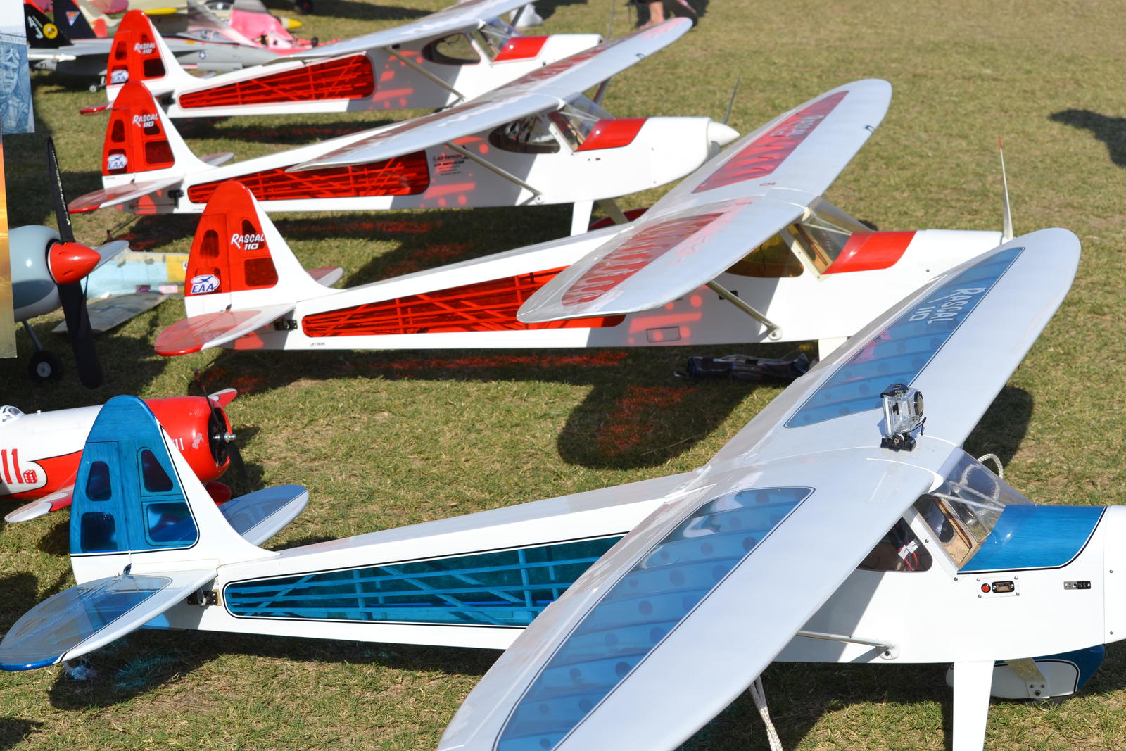

Team Rascal pics at SEFF 2012 a few weeks ago.

Thanks for that photo Mr Moose. Being at SEFF I supose they were all electric. Did they all seem to have enough power? Brian

Great picture. I sure would like to have some info on that camera set-up on the blue one.
