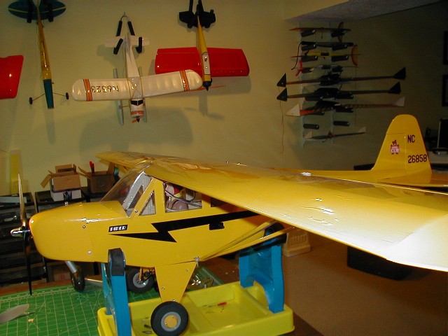

You guys asked my to post a quick review of my new WM Cub (71" span) build, so here it goes.
Overall this is a great ARF. It’s a great value, complete, and easy to build. I did find a few quality issues, such as holes that were not drilled, and the covering, which just needed some shrinking.
I tried to keep things on the inexpensive side going with Tower 3000 standard servos all around, and a Tower .46BB 2-cycle motor. Everything considered, this model is less than $300.
As you can see this is a great looking model. It looks and feels solid, one of the best ARFs I’ve ever put together.
I’ve not maidened this yet, still waiting for that windless day which is few and far between in Northern Virginia. I’ll let you know how that goes.
Enjoy.

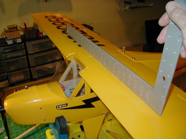

I have that plane with 12 cells on a brushless motor. It flies great. I noticed that your's has the same problem as mine and that's the negative dihedral. I adjusted my struts to compensate. If you lay a long straight edge along the top of the wing it should lay flat.
It's an easy flying plane. Fly it slow and it will be very forgiving.

Thanks. I can understand why so many guys e-convert this model; it is very light for the size. I typically fly electric, but have been building a few glow models lately.
You freaked me out. I put an edge on the wing, seems okay. How does it look to you guys?
How did you adjust your struts, by the way?

The edge is flat on the wing.

Note the struts where not attached in that shot, but it's about the same when attached.

Good for you. It looks like yours is OK. The second pic of this thread makes it look the wings are drooping.
To fix it, I elongated the hole in the strut at the wing attachment.
-Ben
