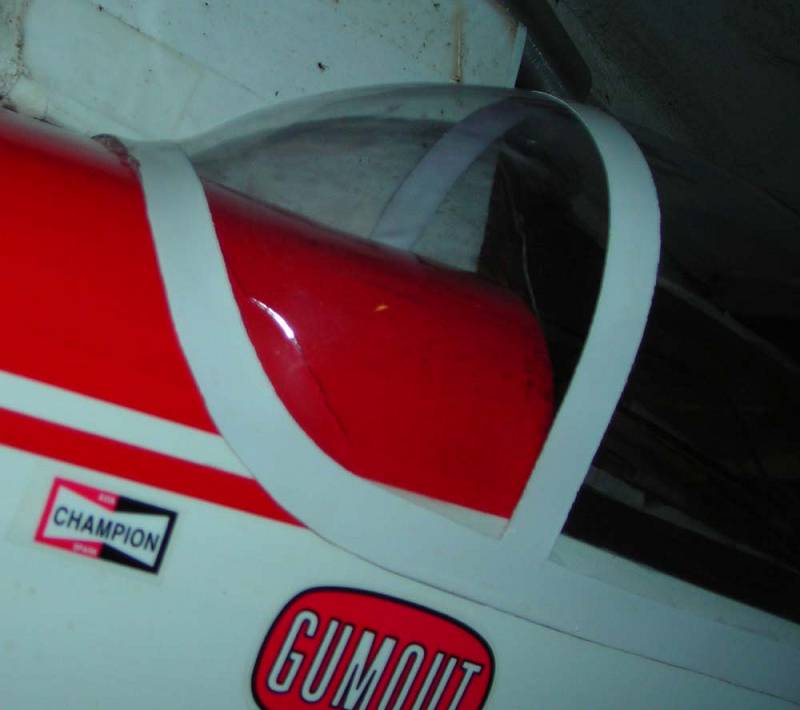

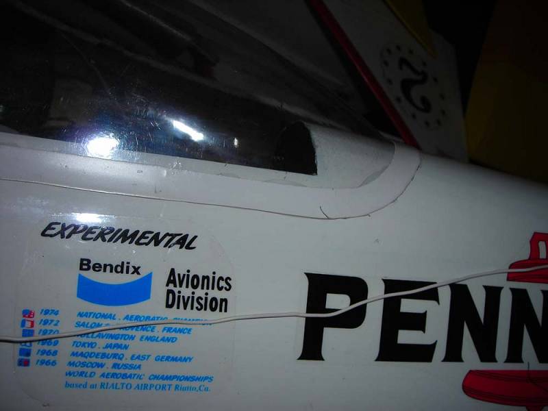

I've used Goop with good results. I put it on the canopy, tape the canopy down, let dry. Any place where the Goop has come out I just rub, the Goop comes off. If I have a spot where there's a slight gap under the canopy just squeeze some Goop in, let dry, rub off any excess.
Here's a Chipmunk I used Goop on.
