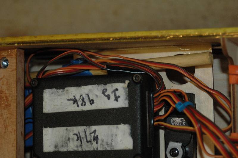

What I did is I taped the batteries to a dowel and gently went as far back as I could and once I got the CG where I wanted it I taped it down so it couldnt move so in the future if I ever have to take them out I just grab the dowel so I didnt have to make a hatch. On each of the servos I reinforced the mounts on the inside so they would stick out.

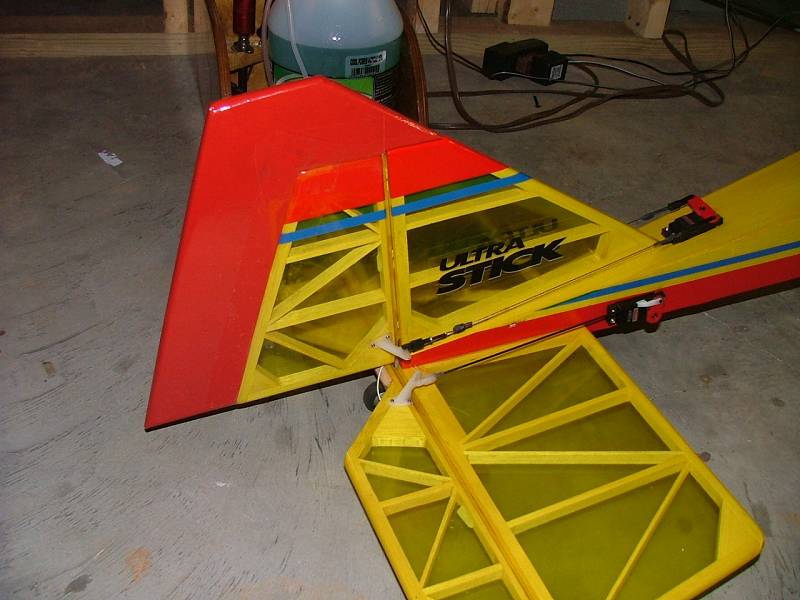

Here is a picture of my US with the servos in the rear ,battery under the wing hold down bolts ,an OS 91 Surpass and no lead in the tail. Also notice the additional rudder made from a US120 Aileron. Gave more slow speed rudder but with so much coupling it didn't help Knife Edge so it it gone now. I just got a set of floats to build for it to try this spring.

here is how I set mine up. as you can see the dowel along side of the radio box. The first battery is about 1"-2" back from the wing nuts and the second is right after that.

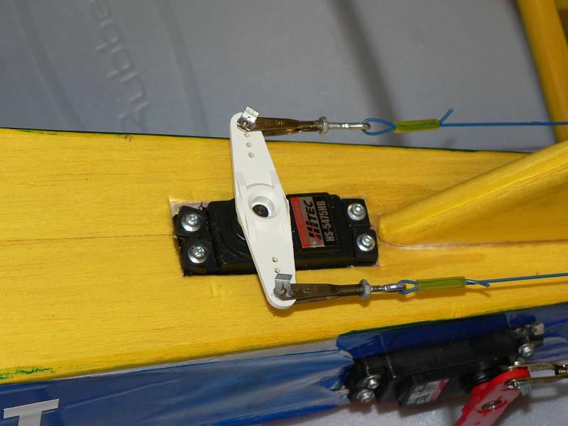

I have an Ultra Stick 60 powered by an SK 90. I picked it up literally before the previous owner placed it in the trash. A buddy rebuilt it with lite ply doublers on the outside. Even with an OS .61SF, my original engine until I got the SK, it was nose heavy.
There is a balance point in the manual, 4 1/2", as I recall, but check to be sure. This CG is not tail heavy or sensitive in the least. Build the plane except for the rudder & elevator servos and check the CG. If it is forward of this point, rubber band one servo in the rear and check. I ended up with both servos in the rear with the rudder on top using pull-pull. You cut the hole and put some scrap ply underneath. It's easy, it works like a champ. I have net heard of anyone having a rear mounted servo come out. You will need a couple of 12" extensions.
Don't worry about oil on the servo. I have been using external servos for years and have yet to have a problem.
I know the sides are blue. We didn't have any transparent yellow and this was a trash can plane. But, even at slightly over 8 1/2 lbs it still flies great.
