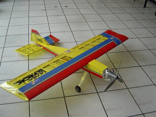

From: La Libertad, EL SALVADOR
I would definitely consider the RCV 90 SP engine. My US 60 is trully vertical with this engine using a 3 bladed 15.75 x 13 APC prop. Will need larger wheels to get proper clearance though...
The RCV is a perfect match in my opinion and would definitely recommend it to anybody.... Just remember to reinforce the firewall from the inside, this engine has tremendous amounts of torque!!!

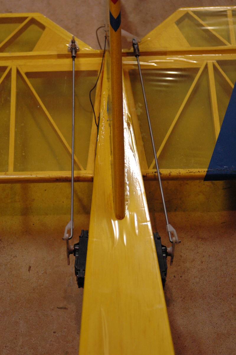

No pictures yet, but my elevator servo is mounted 3" in front of the LE of the stabilizer. (that's the center of the servo) It is mounted as low in the fuse as possible, on the right hand side of the fuse.
The Rudder servo (pull pull setup) is mounted in the very center of the top of the fuse, and it is 8" (servo center) from the LE of the stab.
I used a short piece of CF tube for the pushrod on the stab servo, and a Dubro Pull Pull kit on the rudder servo. With a ST 90 on the nose, I still had to add 3 little stick on weights on the tail, not much at all really.
This definitely the way to go. I would do it again in a second.
Ernie

Dave, if you don't mount your servos in the rear you'll wish that you did. There is only a small learning curve to it. (email me at [email protected] and I'll send you some photos this coming weekend)
I mounted my battery as far back as I could without burying it in the fuse. That was easy because with the servos in the rear, you can remove the stock servo mounting tray and mount the battery back there.
Don't worry about the oil on the servos too much. The top, rudder servo stays totally clean and the ele servo only gets a small amount of oil if you angle your muffler down AND use an exhaust deflector on it.
For the servo mounts, you just cut out a hole and then glue some ply mounts to the inside of the fuse. I can send you a photo of how to make those little mounts also. Very easy. And if you have never used a pull pull setup on the rudder, you will be in for a treat.
Ernie
