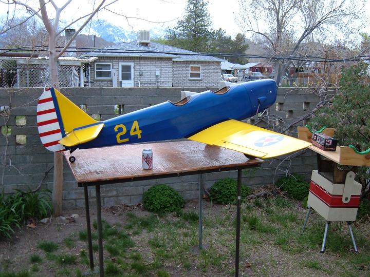

I tried an on board glow system on my giant scale PT-19/ inverted O.S. 1.20 Surpass. The first trip out was uneventful and the system worked good. The second time out, there was some kind of problem that gave me severe radio interference. I was very lucky to land the plane safely. I brought the plane home and test ran it again. The control surfaces would intermittently go ape. I disconnected the on board glow and the problem went away.

Whose PT-19 you got there H9, Great Planes, or a Dynaflite? I have a H9 with a YS-140L mounted inverted in the nose. Other than a bad needle valve, which I have replaced, the YS runs flawlessly. Then again the YS is a pressurized system. Just don't lean them or you will be eating prop. I do have a remote glow plug so the glow driver doesn't have to plug onto the glow plug from the bottom.

bluemax, it's a Dynaflite. I did a little research on my onboard glow problem. I guess sometimes a loose connector to the glow plug can cause a radio interference situation. If I ever try it again, it will be on a cheapo model for the test, and I'll make dang sure the connector is tight.
I think 191557's set-up is probably the best. No intricate circuits to fail.

TimC, Nice PT you have there.

Nice looking PT-19 and I'll bet she is a dream to fly. The H9 one is.
