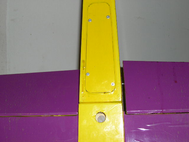

Here is a pic of the hatch I made for my t---t. I have an os 61 on her I now wish I had made the hatch just a little farther back because she is still nose heavy.
I plan on making a cg stand for her tomorrow an get her balanced correctly.
I tried hovering her today and was having lots of problems with her.
I was able to fly her around on high rates today it's just going to take alittle time getting use to her.
Boy I gotta love that os it is just so smooth

btw pardon my dirty plane I just havn't had time to clean her.

That's a pretty slick hatch... However, I would like to try and make the battery more accessible because I'm very anal about balancing (balancing the lipo voltage, not the plane)... lol.
I'll probably try it up front like normal at first then if she needs to be more tail heavy, I'll go from there.
Can I bug you for a photo without the hatch on? I need to do something like that on my Ultra Stick. It's still a NiMH plane and I've got a bit of lead on the tail that I'd very much like to get rid of.
-Eric

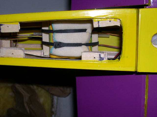

Wouldn't you know it my camera batt is down but what I did was 1st was I put in a piece of balsa stick 1/4 with a piece of light ply over it and glued it to the weak area on both sides the fuse that always seem to crack. Then I glued a piece of light ply on them. I wrapped my batt in foam and zip tied it the the plywood floor that i made.
When I cut the covering out for the hatch I used the covering for a template for my light ply hatch cover. I also glued some light ply pieces on the inside bottom fuse for the hatch cover to rest on and screw to.

OK here the pic. That a good ideal to wait till you have the engine mounted before installing the batt and also waldo's set up is more than likely better for you as you will be removing you batt for charging.

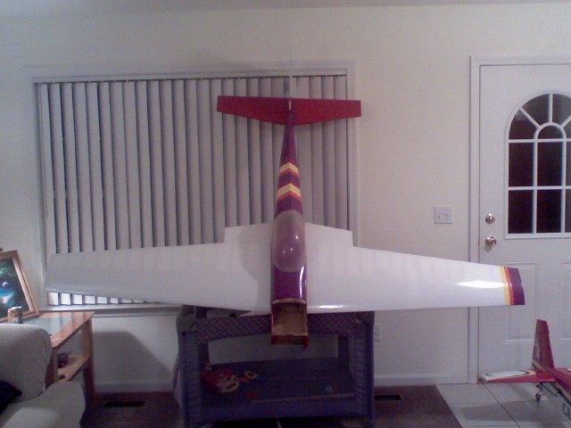

All I can say now is ouch I have burned the bejesus out of myself with that darn iron. He she is with the wings covered minus the ailerons(still workin on ironing my skin back on) LOL. Oh yeah and just a few of my planes too just so you all can see I have been a busy boy.

T_ _ _ Ted sweet job on that Laser, I may have to build me one of those, it looks sharp, and nice hanger I might add, you have been a busy boy,,, and its going to be some feat to build a plane to fly your 160 lb puppy around,, I have a chihuahua, I think he can fit in the T_ _ _ T 40

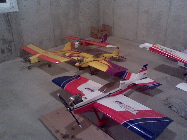

Thanks Waldo just a few more hours of covering and she will be ready for her life support. Yea I need a bigger plane for the dog now. 99 inch wing still a little small. I have been doing so good this winter building, I really enjoy the build but not like I love to fly them. Hows the bipe coming? I am gonna get the laser done this weekend it looks like the weather is gonna stink Sunday so I will be here inside again or shall I say still!

T---Ted you have been busy looks like you'll have plenty of planes for the season ahead

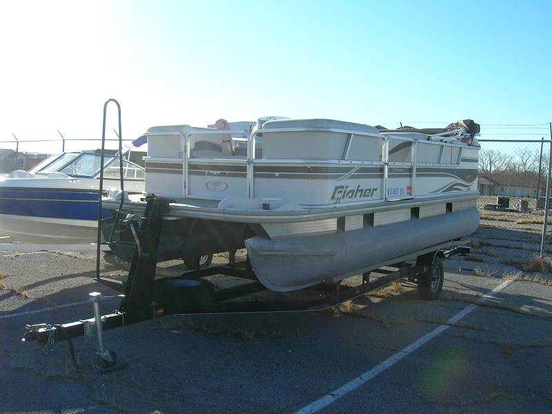

Well I'm still around. I haven't been flying much, But I got a summer toy that I have been rebuilding. Trying to figure a way to put a landing deck on it [X(]. Yall have been busy this winter with your planes. They all look Great. I still have the same ones ( which I guess is a good thing ).

Kerwin: Thanks for the picture. It looks like you just ran wood screws straight into the spruce rather than using nuts... I might have to do that same thing. If I mount the battery low enough, I can get my balancer in there pretty easy.
