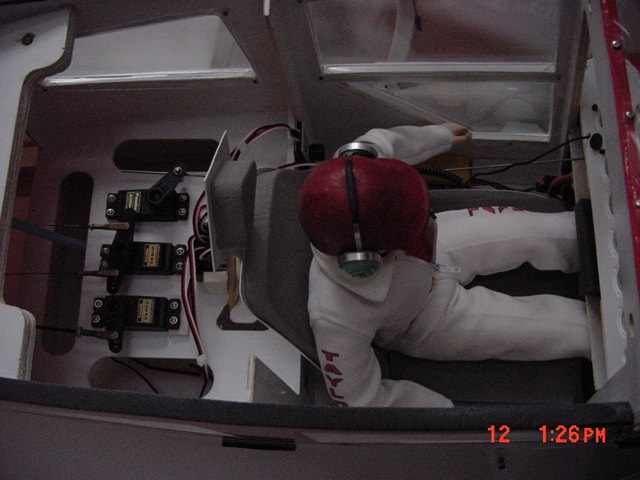

I took a few pictures but I can not get the size correct. Do you know how?

Old 02-12-2003 | 11:08 PM
Posts: 1,331
From: BILLERICA, MA
Default H9 Taylorcraft
How is this?

Old 02-12-2003 | 11:13 PM
Posts: 255
From: Pleasant View , UT
Wow! Looks good - can you get a front/side shot? I see you used a single elevator servo - did you use the y - stick the inst. show?Are those 9202 servo's?
