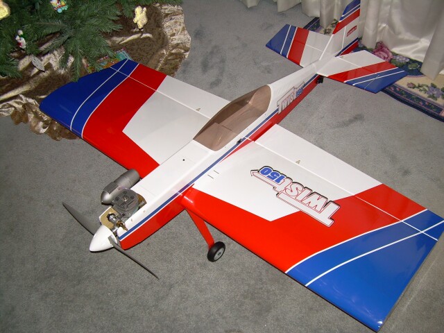

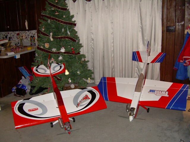

Got my Twist 150 ready to fly... just need some good weather to maiden it now. It balanced out perfectly with the Thunder Tigre G2300 and the radio gear in the recommended positions. The red & black Twist in the photos is my Twist 60 for comparison...

I finally maidened my Twist 150 today... I ran one tank through my Thunder Tigre G2300 to break it in a little, and got a couple of flights in before the snow started coming down! I still have to lean out the low end needle some more, and tone down my low rate ailerons a little for my liking, but from what I can tell so far, if you're a Twist 60 fan, you won't be disappointed in the Twist 150... I'm very pleased with it. It seems to float in for a landing even slower that the 60 does. It seems to knife-edge as well or better than the 60. With the G2300, it seems to have plenty of power, even though it's new and running a little rich right now.
