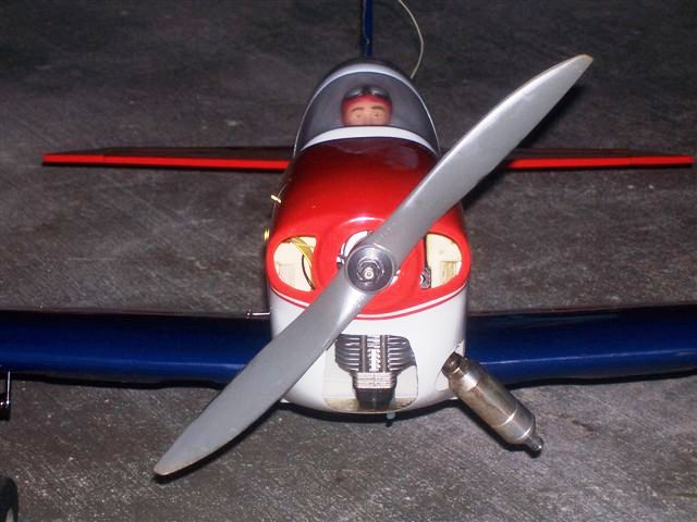

I am ok with it. I did cut away a little more that i would have liked and i could have ran the muffler inside the cowl pointing out the bottom and cut a lot less out but this is the way i did it so what's done is done. I am by myself tonight so i should get it pretty much finished.

Great looking plane Flyboy! Yours too Tianci. I too have a couple of pride pics as well as an "assembly engineer". Let us know how it flies!
And although it's a little late, I am adding a pic of the inverted mounted front shot.

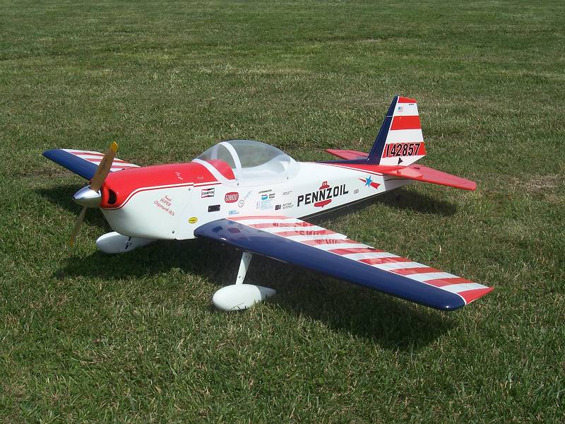

[img][/img]Trying to upload a pix of my chippie, flyboy I think you need to put a elmo pilot in your chippie, I am sure your engineer would agree
