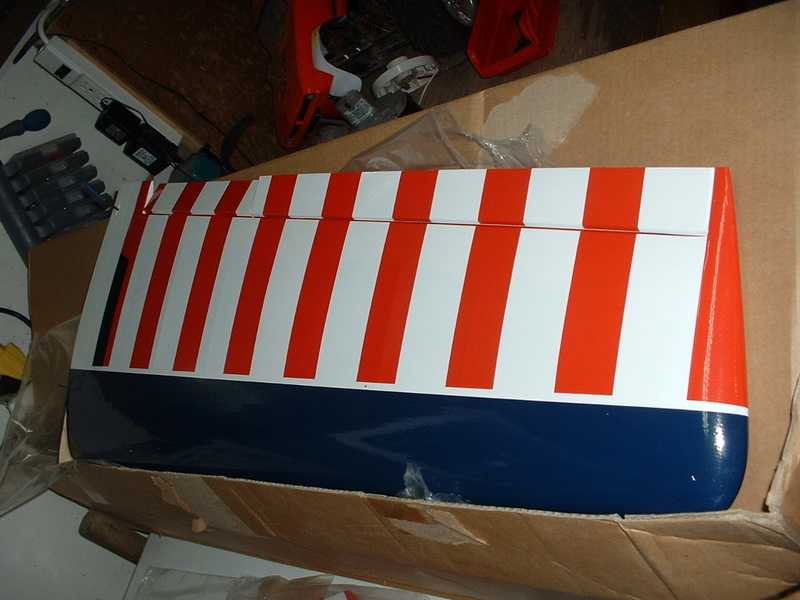

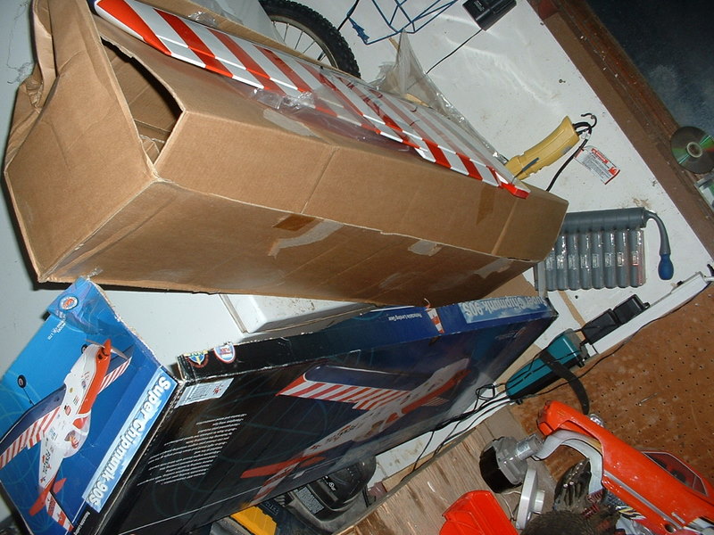

OK hockey is over and it's time to get started. This will be a slower build as i won't have a lot of time during the week-days to work on it. Tonight all i did was pull the box out and check to make sure all the parts were there. I have to say that while the box that it came in was mashed up good i was really impressed with the quality of the plane and the hardware that came with it. One thing i will be changing is the pushrods, they are really stiff and don't take a bend well. I will swap them out with some softer ones. I did epoxy on the servo mount blocks to the aileron hatch cover, and read the manual several times cover to cover. Now is the time to chime in with what smoke system you are using and if you have any ideas for mine. I have never dealt with smoke before.

I should mention that this box has sat out in my garage the entire winter with temps ranging from -5 C to +20 C depending on if i have the heater running out there and the covering was beautiful, i have one small sag that i will hit with the iron and other than that it is mint. Even the manual is decent which is saying something coming from China. Thats it for tonight
