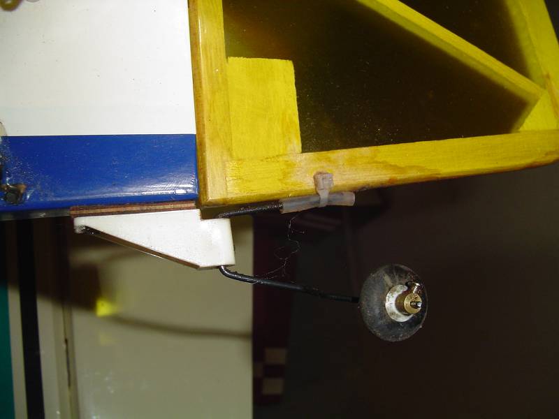

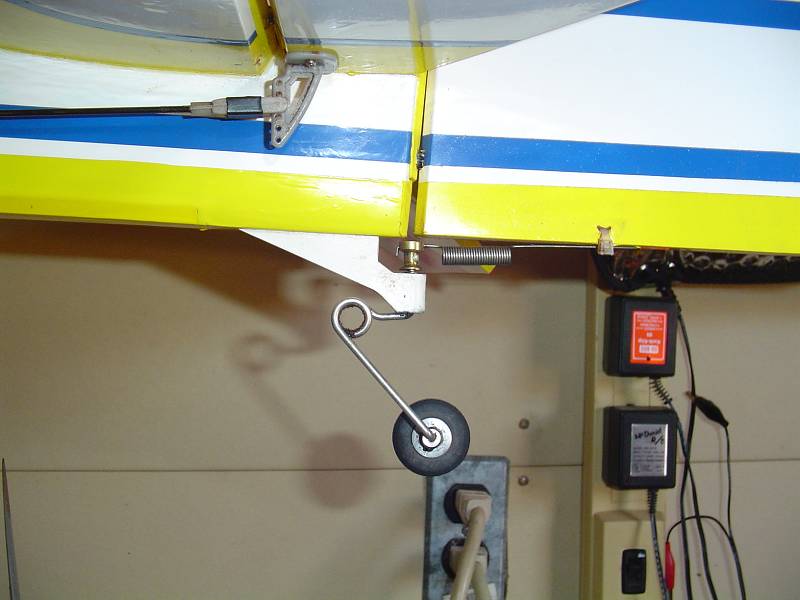

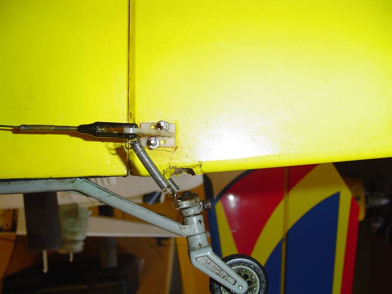

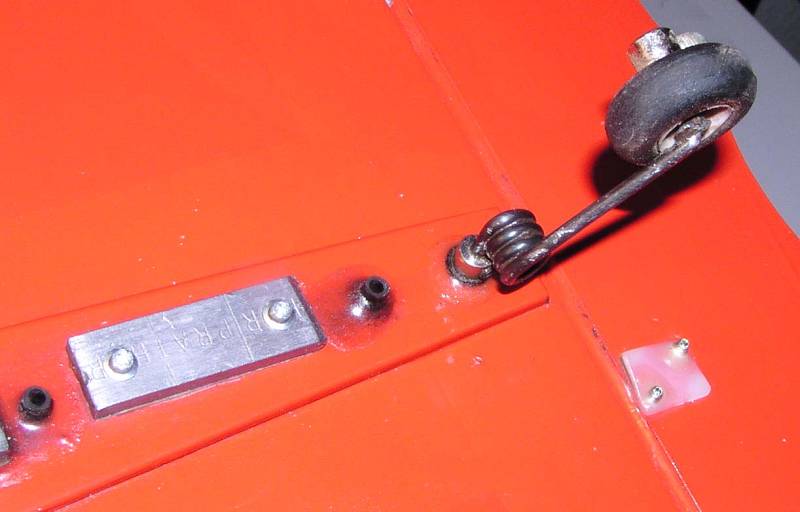

Here are 4 good ways. The first one came with a kit and I bent it under the rudder instead of in it. The second is a Sullivan. The last two are both Kleet from Goldberg. Showing two different ways to hook up the pull/pull.
David
