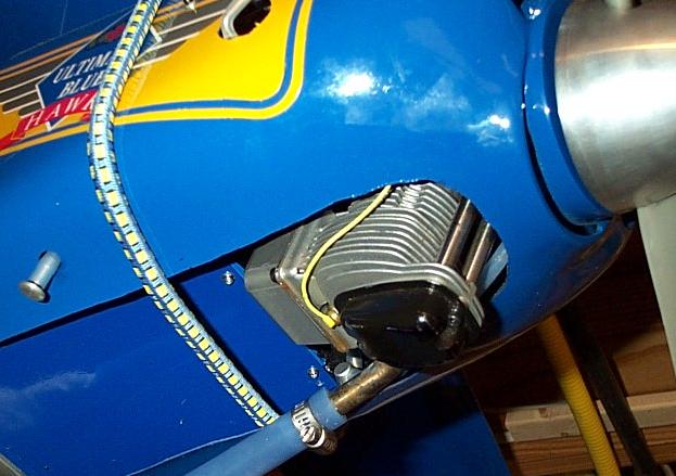

Here's my Ulty with YS91 inverted. Uses remote glow igniter (glow driver not needed), remote fueler and the YS straight header with silicone extension. Runs strong, silky smooth idle and does everything in the book. Power-O-plenty!
Flies great, keeps up with other club members GB Ultys with OS 1.20's, but sounds better (IMHO)
