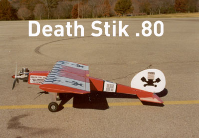

I have an Enya 60 bored out to a 80. It weighs 15 ozs without a muffler. I figure if Hangar 9 is pimping the MDS .58 my Enya couldn't be that much bigger. How does the crow work with the .72 on it? Doesn't the .72 weigh something like 17ozs? I've was going to wait until I had the "model money" up for another engine but the Enya is just sitting there begging to go verticle!
Here it is on the front of a GP Big Stik .40 (deceased).

I replaced the metal motor mount with a fiberglass one and have the motor as close to the firewall as posible. I know the .80 is a bit much but it's all I have on hand and it's a sweet motor.
