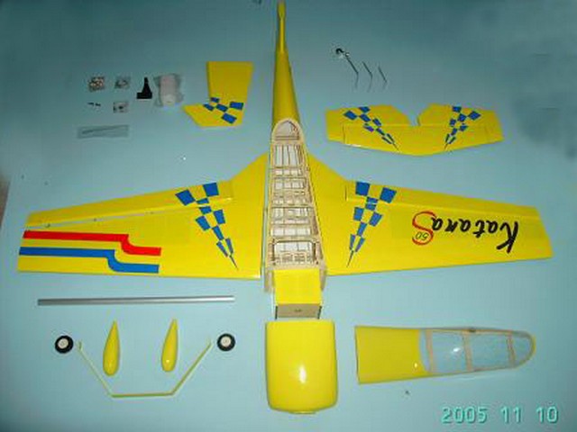

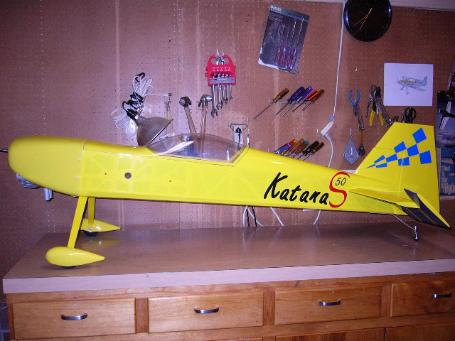

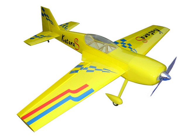

Well, I bought what I thought was a cheap but beautiful Katana S 50cc ARF by Flight Models, only to be disappointed in repeated flaws in the building. The covering material is the worst I have seen, but I could get over that. My problem now, is that I noticed the fuselage tail has an ever so slight twist. Only after the stab was glued in with Gorilla glue did I notice the slight twist, which shows up as one stab being lower than the other side. The stab slides through two laser cut slots on each side of the fuselage for it. The wings were not on when I glued in the stab, and only after I got the wings on did I notice the stab is tilted in relation to the wings. What can I do besiges throwing it away .... to fix this stab situation? Trying to cut that stab out of the plywood fuse sides seems .. ??????

Can you get a pic from the rear?
How much is "ever so slight"?
Is the Vertical Fin also twisted?

I'd be more concerned about that pusher prop (your 1st picture).

I'd be more concerned about that pusher prop (your 1st picture). .. and yes, I am VERY concerned with aesthetics.
Your statement is very true, however the wings WERE on .. when I measured up everything and marked it. I had a little bit of difficulty getting the corner tip of stab to the corner tip of wing to measure out initially. After I got those measurements to equal ... all looked OK. What I didn't do was pick up the tail and visually inspect that the stab and wing were on the same horizontal plane. I never thought that the plywood sides of the fuselage might be 1/16 off. .... 1/16" off at the fuse shows up as something like 3/8" off at the tip, when comparing left stab tip to right stab tip .. and to me is very noticeable.[&o]
.... That first pic is the manufacturer's pic, .. and yes that does look like a pusher prop they have on it. Now you see what I'm dealing with.

MinnFlyer, I'll try to get a pic of the stab from the rear later tonight. I think I know how to attack it now though ... but would still like to hear suggestions. The vertical fin is not twisted. Its like when the two sides of the fuse were mated at the tail post, one plywood side was slightly lower than the other.

I have edited my post 3 times ... changing how much the difference is. I once had 1/4" ... 3/8" .. and once I had 1/2"! I'm not totally sure what it is. I didn't measure it last night when I saw it ... because it didn't matter ... All I know is it shows up BIG TIME! If you were walking down a flihgtline .. looking a planes lined up with the nose first, .. when you got to this one ... you would see .. spinner, fine ... cowl, fine ... wings, fine .... then you would see ..stab tilted! While looking across the plan-form of the wing, your peripheral vision would also pick up the stab and its non parallel horizontal line in comparison to the wing. Its unacceptable. Something has to be done. One of my pet peeves is things that obviously don't look right. Its my fault, I understand that .. but I can't live with it. You'll ne3ver see me fly with out a cowl or wheel pants ... I can't stand it .. I can't do it . Aesthetics just mean too much to me. So, .. how did I let this happen if I'm that anal ??? ... I don't know.
