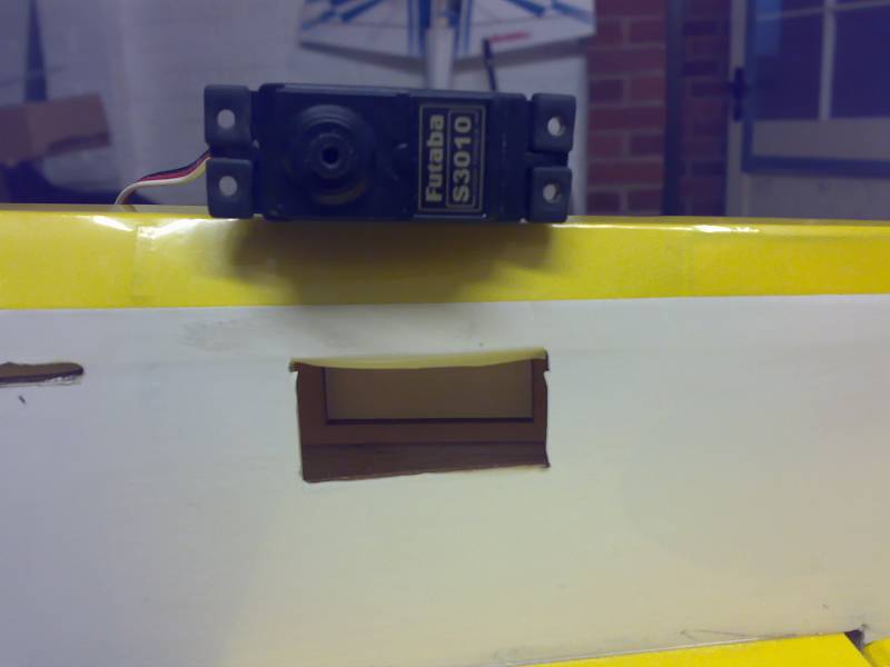

I have recently purchased from Peakmodels the Extra 260. I can not complain, so this post is not a complaint at all. Quality is good and great value for money, but I am trying to fiqure out how the hell can two servos fit at tail in the space provided after removing the covering either for dual elevator or rudder/elevator setup ?
[img][/img]
I prefer to use two servos equal distance from the control horn so I can easily move both the servos towards the front a couple of inches where fuselage gets thick, but there is only covering !!!!! so that means surgery to my plane to fit them .
Is this possible that a plane was made with this fault ? or am I doing something wrong
anyone out there got pictures of their setup ?

Maybe you should be using lower profile servos with support blocks at the fuselage for each.
A small ply block where the screws go in would "lift" the servo a hair, and give you enough space to mount two mini or low profile servos.
Like this, but with the blocks on top, instead of under the screw as it shows in the picture.

Yes thats what I thaught but it doesnt mention anything on manual that you need such servos. I think I will put one slightly lower thanthe other and see how it goes but I still think there is a mistake somewhere

I am going to use 2 x futaba s3010 servos on both elevators and a high torque Hitec for rudder using pull pull configuration, this can be tricky (pull pull) cause NOTHING is mentioned in manual and cables can come very close to elevator servos but you do have space for servo in middle of fuselage. So I will have to find a way of avoiding contact of cable with elevator servos.
I must point out that you need to do some reinforcement on rudder. I did not like it so reinforced it using 1/16 ply as shown in pictures.

Do you mean 2 x futaba s3010 servos can sit back to back in the servo bays previded? and how much each s3010 cost? I am using only a futaba s3001 for the the elevator for normal flying at the moment.

Nowink thats my main problem , infact thats why I started this post cause whatever you do, ie 2 servos for elevator or one for rudder and one for elevator , they dont fit back to back using the `cut-out` in the fuselage provided by the manufacturer, as illustrated in the pictures.
As regards to servos, I just happen to have s3010s and I dont think s3001s should be a problem for elevator halves, but do not use 3001s for aerolons ! You need a bit of more torque for these or at least metal gear servos.

Finally got it done. This is my dual elevator setup.
Each servo is equi distant from elevator control horns, but the servos are not back to back cause if you do use the servo space provided each servo would be half way out, so I cant understand why there are two space for back-to-back. So I cut a servo slot so that one servo lies on top of the other.
In doing so you have to close up one of the original servo space provided and re-inforce otherwise the this end of the fuselage may snap ! I re-inforced it with peaces of carbon fibre stips.
Rudder is then pull pull. Note in pictures that I was lucky that cable just cleared out of elevator servo
