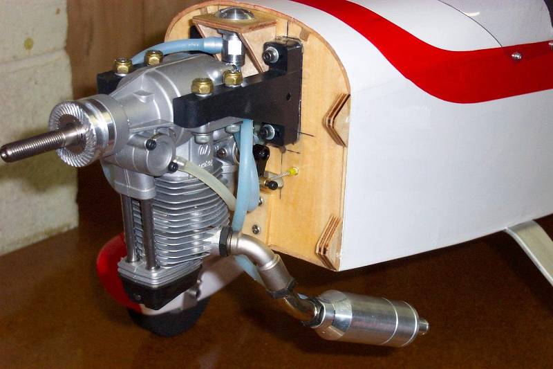

No, I didn't change anything there..... The crankshaft is "still" on the preset thrust line just as if the engine is mounted upright, 90 degrees left or 90 degrees right

I have finally been able to obtain a SIG Kadet Senior Arf which was no easy feat to say the least. I want to mount a Saito .80 inverted on this ship so as to maintain the asthetics as best as possible. I understant that I will need to lower the fuel tank so that I am not siphoning fuel into the carb. I noticed further up the post you mention this modification where you lowered the tank about an inch and a half. How did you do this? Dremmel & flex shaft tool or?? Also you purchased a landing gear set after market, could you please provide me with the dimensions as I like the stance of your kadet, also were there any off the shelf gear sets that you know of that come reasonably close to your custom set? Also what diameter and make are the main wheels? I have an extra set of wheel pants sitting around which are .60-.90 size and I think I can modify them to work with this kit. Lastly, you mention an exhaust extension which looks real nice as you have been able to divert the exhaust away from the ship really effectively, are these extensions after market or only an OS option? Thanks for the very informative post on these really cool mods [8D]

On the tank relocation...I did it with a dremel tool. Flex shaft would have made it easier but I didn't have one. It's a very worth while modification.
Engine mounts were relocated keeping the engine on exact same thrust line (precise calculations were necessary here)

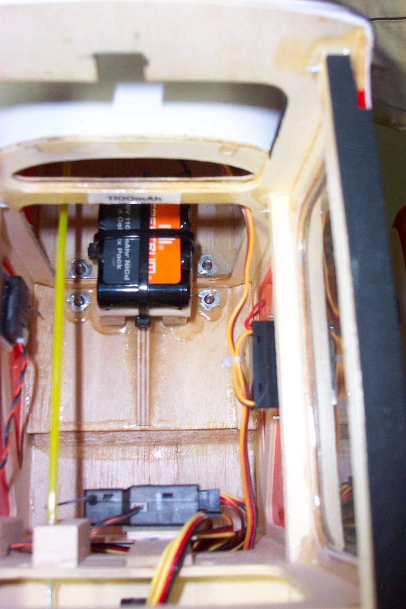

Here are a couple pictures of the on-board glow system. I used a 1.2 volt 3000 mAh Sanyo Sub C. It seemed to work well. I only had to charge it every other flying session. I had it set to come on once throttle was at 1/4 or less.
