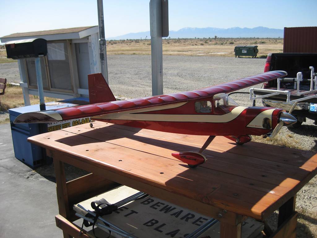

Here is my completed Kadet tail dragger conversion. I put a Saito 91 in her. She cruises at about 1/8 throttle.

Looks mighty nice
