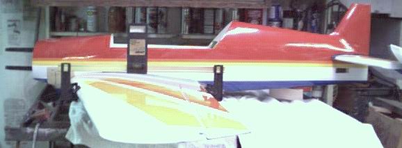

I'm not sure how you would check an unbuilt fues but I might be willing to send mine back. The Stabilizer is mounted and I checked last night and with the wing at 0 degrees this fues actually has -1/2 degree of incidence in the tail. I took some pictures, but my camera is not all that great. You can't see it well enough in the pics but you can see my set up and the wing reads zero and the stab -1/2.

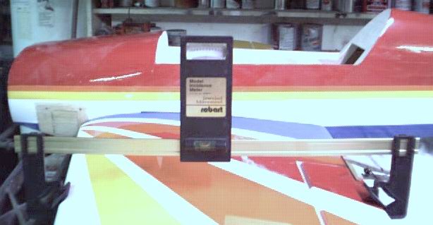

This pic shows the wing

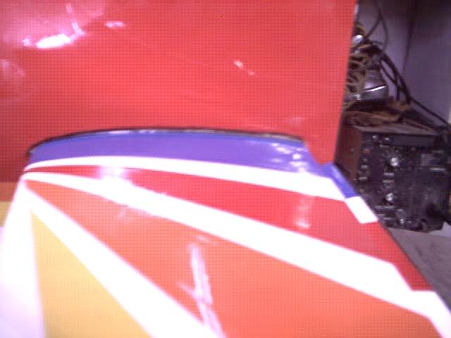

This is the tail shot

Default Stab Mounting
Here is a close up of the stab mounting. You can see that I propped the LE of the stab up close (No gap) and let the TE drop down.
And you know I just realized that the -1/2 on my incidence meter is actually LE up on the Left side of the airplane. So I actually have +1/2 incidence. Sorry about that.
If I didn't prop up the front I probably would have 0 incidence.
Rick
