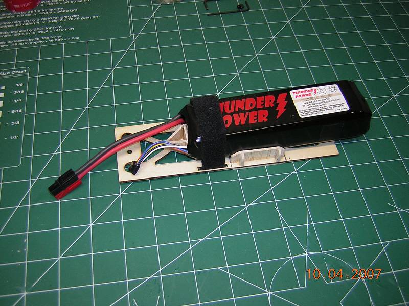

Here are some pics of my battery installation for the electric version of the Tango. This battery position puts the CG at 4.75" aft of LE with no ballast required. Note the ESC and BEC are all the way forward too. The battery is a TP 4S5000mah weighing 17.25 oz. AUW is 5.3 lbs.
I built up the plywood battery mount a little as shown in the photo. It fits in nice and snug. Also notice I colored coded the aileron cables so plugs can't be put on backwards.

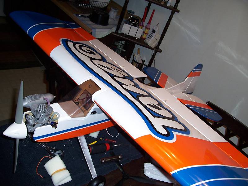

Here are a couple of pic's of my Tango. It has an GMS 47 on it, have used both 10x6 and 11x5 apc props. Also I'm using standard Futaba servos and a 5 cell 700 mah rx battery. I'm having a lot of fun flying it in the wind. It does both right side and inverted flat spins well.
